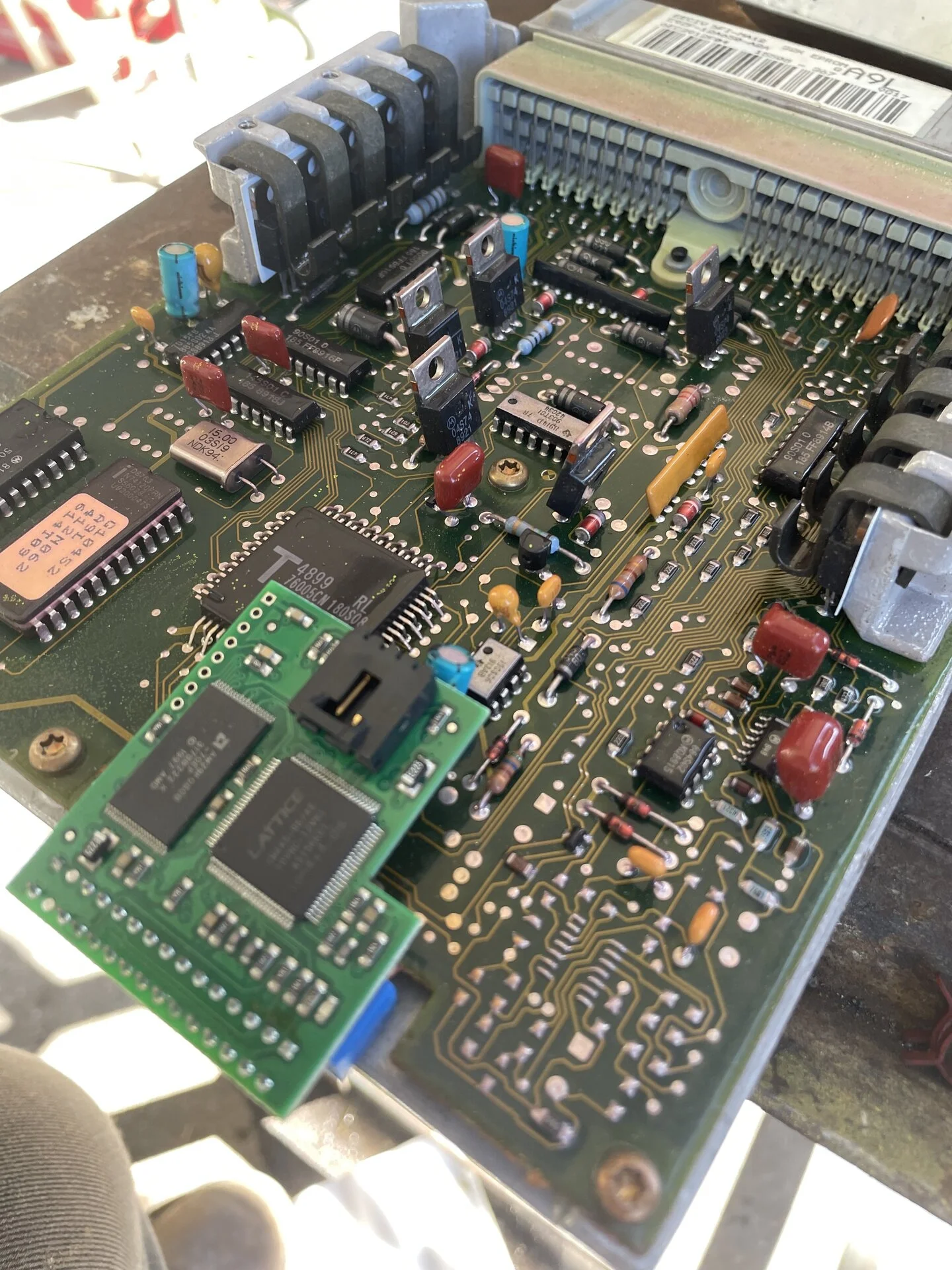

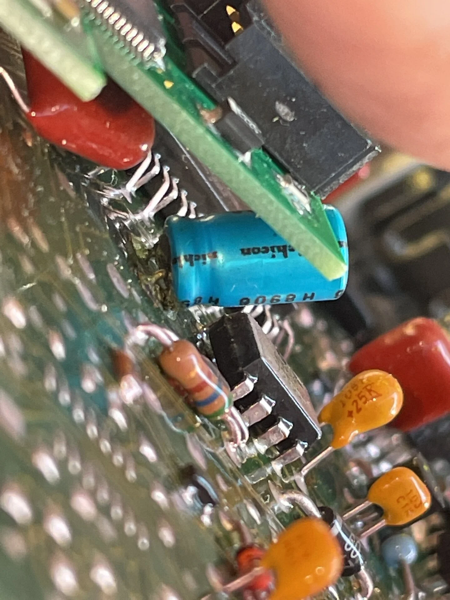

KAWMAN2 Member Aug 9, 2022 65 6 18 32962 Sep 7, 2022 #1 Sep 7, 2022 #1 Al9 butcher has anybody have an idea about the small board, the al9 has 2 leaking capacitors thinking this has been my problem? Attachments ADA738F3-C1E8-4771-9457-277C3EDF4E4F.webp 215.2 KB · Views: 218 B9B79EF0-8BAF-4ECB-9008-A9070E4A2429.webp 312.9 KB · Views: 194 1CB1DA0A-40EE-4711-9C30-ACC5596EA2E0.webp 361.3 KB · Views: 180

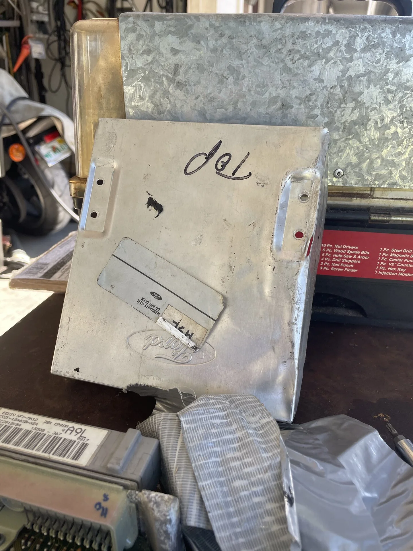

KAWMAN2 Member Aug 9, 2022 65 6 18 32962 Sep 7, 2022 #3 Sep 7, 2022 #3 Just installed a A9P car soesn't run much better has pulled some new codes 31 81 82 85 84 10 ?
General karthief wonder how much it would cost to ship you a pair Mod Dude Aug 25, 2016 28,114 10,733 213 polk county florida Sep 7, 2022 #4 Sep 7, 2022 #4 These computers are 30+ years old, send that thing to the ECUEchange and get it fixed and updated right, I won't use a computer without having them look at it first. KAWMAN2 said: Just installed a A9P car soesn't run much better has pulled some new codes 31 81 82 85 84 10 ? Click to expand... Reactions: Shakerhood and nickyb
90sickfox Wasn't a pretty sight...and I've got big hands SN Certified Technician Mar 2, 2015 6,953 5,831 213 Sep 7, 2022 #5 Sep 7, 2022 #5 That's a performance chip. It doesnt look like a Moates Quarter Horse so no idea what brand.
KAWMAN2 Member Aug 9, 2022 65 6 18 32962 Sep 8, 2022 #6 Sep 8, 2022 #6 I had 3 computers turns out 2 were bad, thing runs great now, found the chip online apperently it has a remote tuner with 3 tunes
