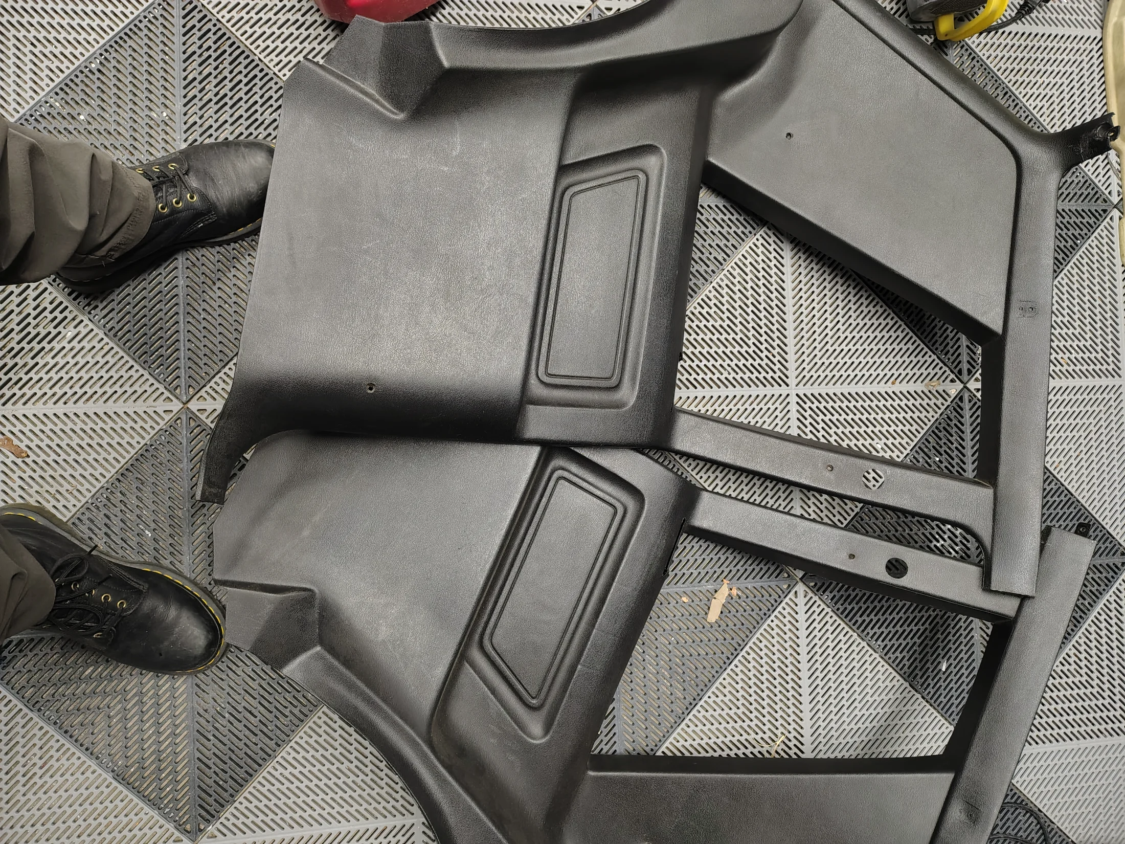

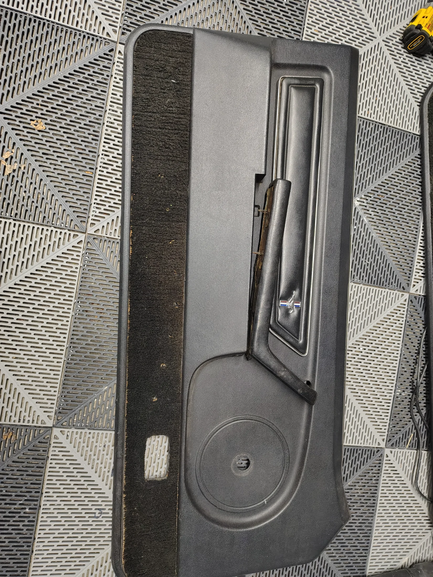

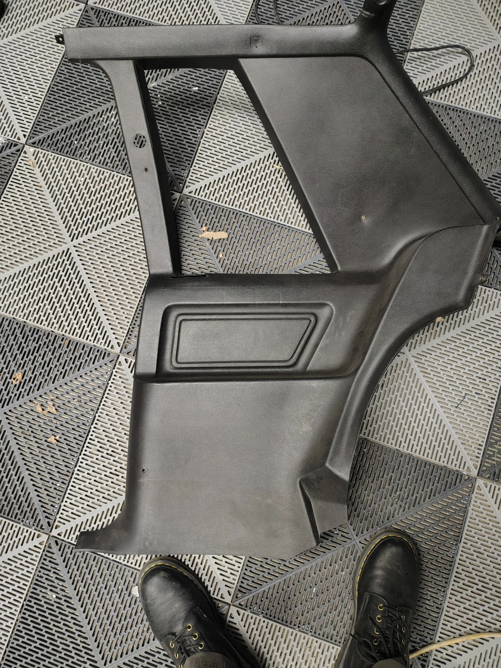

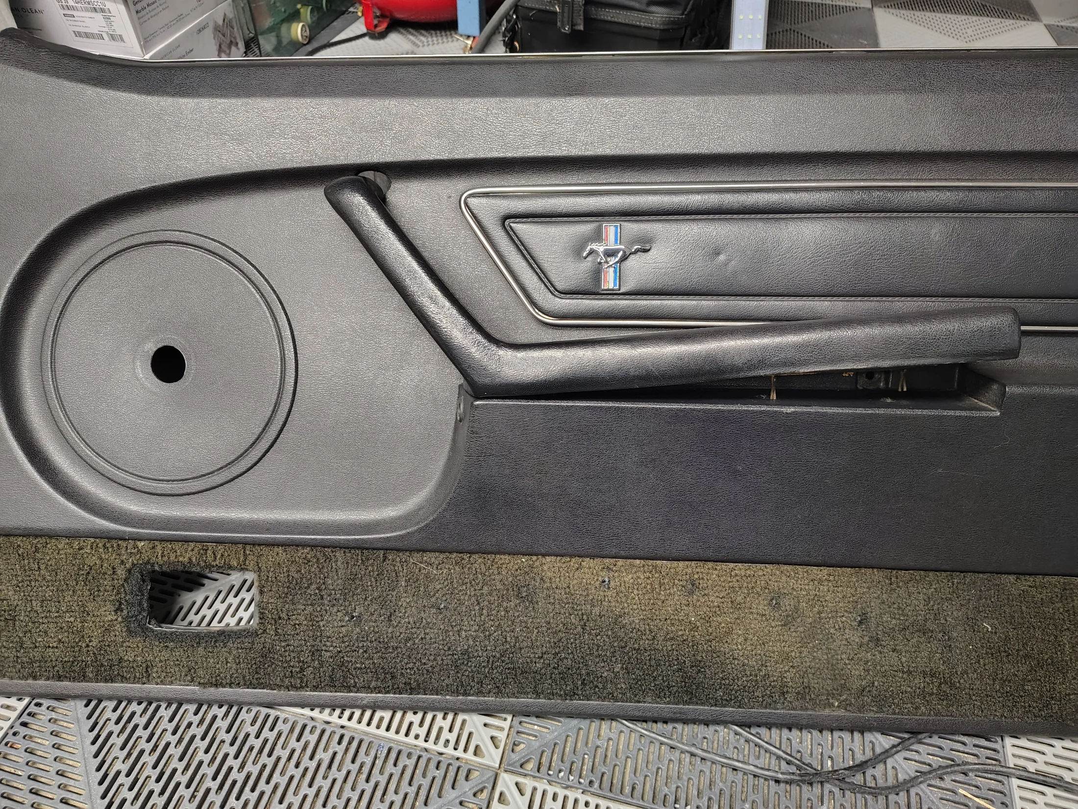

In the search for weight savings I have decided to go with manual crank windows .I was on the hunt for 79-80 door panels for my 1990 mustang.. My question has anyone installed the 79-80 door panels with success in later model ? I know the the armrest/pull doesn't line up and I would have to cut a new hole for lock switch and door handle .. Unfortunately these door panels are extremely nice and so are quarter plastics I couldn't leave them behind but damn there almost to nice to butcher up .My dilemma sell everything and continue the search or butcher up the door panels ... Thoughts and opinions

Just recently there were some people desperately searching for these..... Seem a shame to butcher them up...
Yeah that's the debate I am having cut em up or just turn around and sell them ..I really was hoping for a set that was in worse shape that I could just recover with four way stretch vinyl..But the armrest/ pulls are made unatanium & good luck finding them let alone a extremely nice panel..
Reactions: limp
Why not just put 87-93 manual crank window door panels on it? Might take a little searching but you can find them.
Honestly I am looking for ways to save weight in a more tasteful way . Yes I could go aluminum panels but for this build with a black interior aluminum panels just not for me . The weight difference between the 1979 door panel and my 1990 panel with the he armrest is four pounds per door .So eight pounds weight savings just indoor panels. And trying to find manual BLACK panels in great shape $$$
