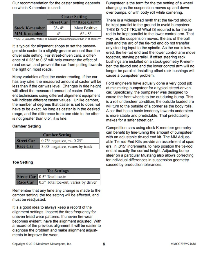

I go by what MM recommends in their caster/camber plate instructions.
SInce i DIY my own alignments, i tend to settle on MAX caster, 1/16" toe in, 0.5-1 degree camber
