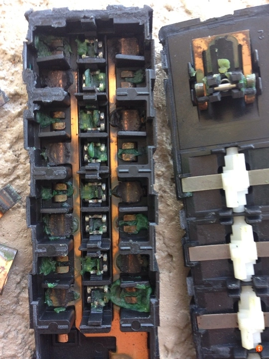

Popped the switch open today:
It was pretty goopy in there. I cleaned out all the grease and checked the contacts. It was glued together so I had to hold it together while plugged in but it worksed. All the snap tabs broke so super glue or epoxy is in order. I'll prolly still get the switch I found and keep this one for a spare just in case.
