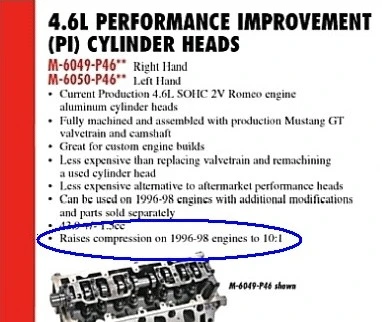

somewhere around 9.0 to 9.2 i think , not sure but its definitely not 10
Which question are you answering? Or are you saying my 10:1 info is wrong? It's 10:1 if you swap PI heads onto a Non-PI engine. See below.

2002BLGT said:
no I knew you were right , but I was saying the stock compression on the PI engines is stock 9 something . I just meant that 10 was too high for a blower in my opinion atleast not a big one .
10 is definitly too much for a blower. Wasn't thinking bout that when I typed the idea.
If I did a blower I would have to do a blower specific short block with rods and pistons minimum.
I may just do a stout N/A setup. My options are wide open at this point. I'm just floating some different ideas.
