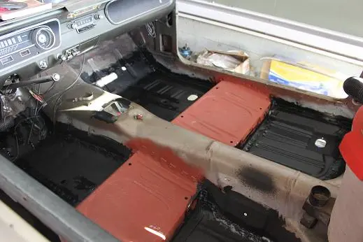

For anyone else doing this I thought I'd post a pic of the fastback with the new floor pans and underside almost done. I did the overlap type install on my new floor pans and then welded above and below. Not perfect but not bad for a rookie. I then cleaned off all of the old undercoat etc from underneath and brushed it with POR-15 semi-gloss black. Once the POR-15 had cured I topped it with something called Pro-Form European Texture GravlGuard which is very tough stuff. I'm now going to seam seal everything and re-install the rear end which was also re-finished. I'm putting in new GAT 4.5 mid-eye leaf springs and all new brake components on the rear drums. Hopefully the rear sits at a good height with these springs.

Nice work, you shld be proud of the job you have done. I'm interested to see how it's sits with new leaf springs so be sure to post a pic when it's done !

yeah ,looking good. nice and clean under side.

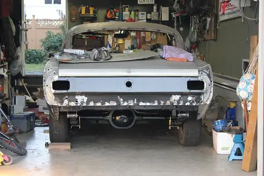

Yesterday I installed the refinished rear end, new 4 1/2 mid-eye leafs and the new shackles. Nothing is really torqued properly yet and I still have to put the shocks in. Once the shocks are in I will post a ride height pic. Here's how it looks from the back right now.
make sure the weight of the body is on the leafs when you tighten the springs .that way the spring bushings will be at a neutral position when tightened/ dont let the rear end haing and then tighten. your doing great
Thanks horsesense. I'm kind of learning as I go using the 'common sense' approach. I'll be sure to tighten everything while the springs are loaded, cheers. The forum is great too..you have all been a big help to me as I go through the process. That is much appreciated.

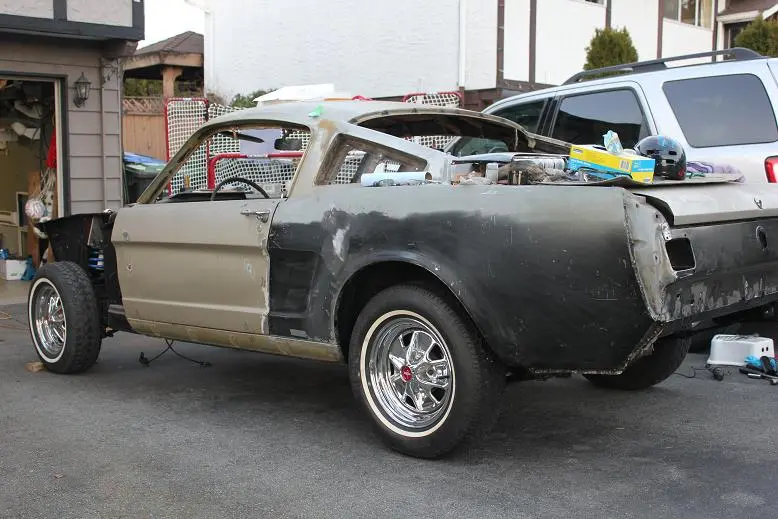

Shocks are now installed and everything is torqued on the rear. No fuel tank in the car which would likely drop it a little. Not sure if there will be any settling with this or not. Rims are 14" and the wheel opening sits 28" from the ground. Anyone know what a stock measurement would be? The mid-eye leafs are supposed to drop it 1" so I'm thinking 29" would be stock.

you will have a bit more settling with bumpers,seats and glass and all the other goodies ,the back window and rear seat is fairly heavy, even the motor and trany will add a small amount to the rear. looking good
