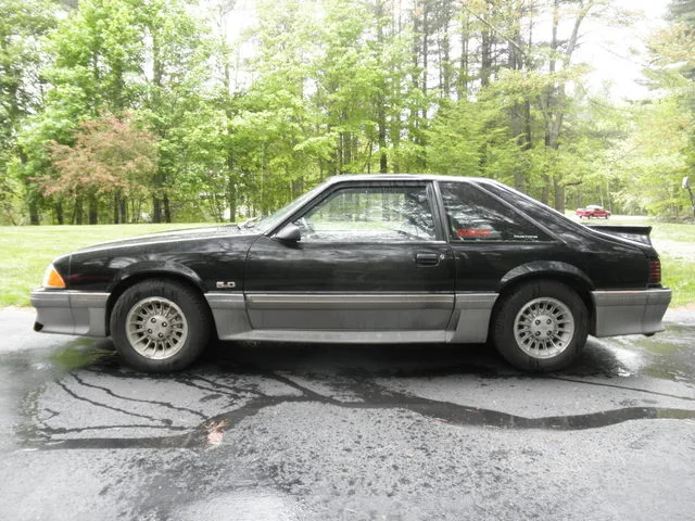

Car is a 1989 Mustang GT with a 5 speed. It was purchased in 2011 (I was a freshman in college) for $3500 with ~83k miles on it and was pretty much 100% stock at the time. I recall searching for 6+ months to find this one, I wanted one that was pretty much 100% stock. I bought it from Rick Menard in Chester, NH (if that name rings a bell for anyone). It has served me well since, as it has taken me through my first internships and then jobs. It was with me when I met my now fiance and took us on a lot of our dates and trips together. When I bought it I knew it had been a New England car its whole life so it never looked amazing. The paint was always faded and a lot of the bare metal had surface rust. I knew eventually it would need some work.
[AS PURCHASED]

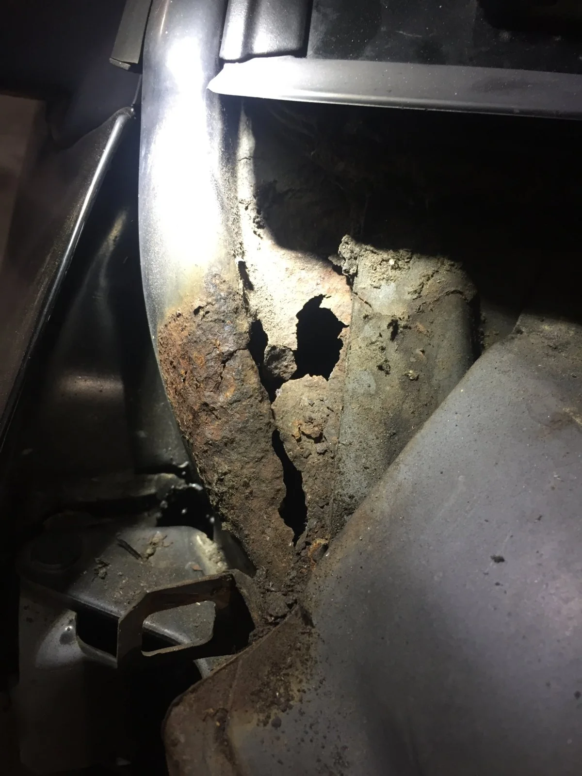

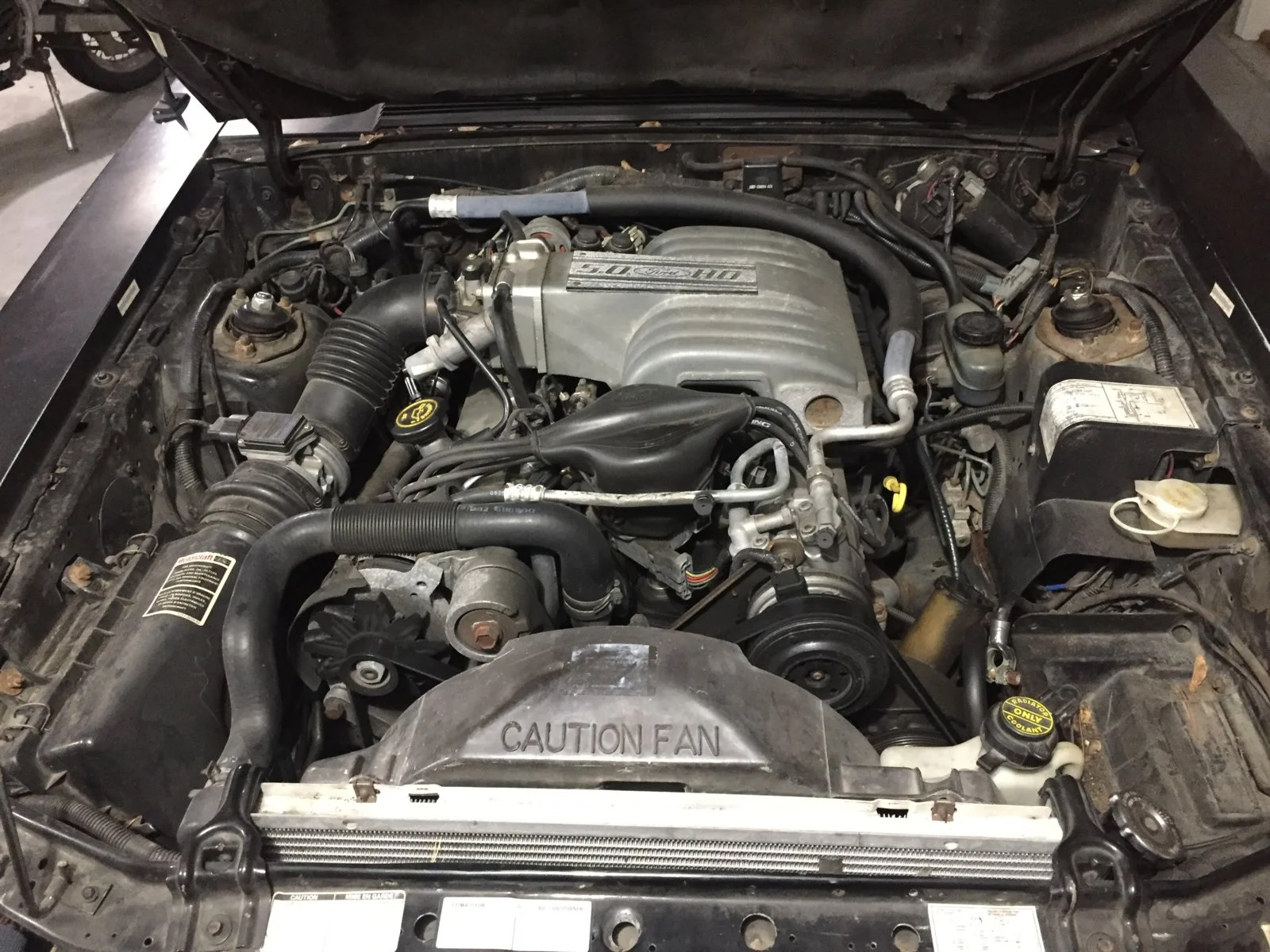

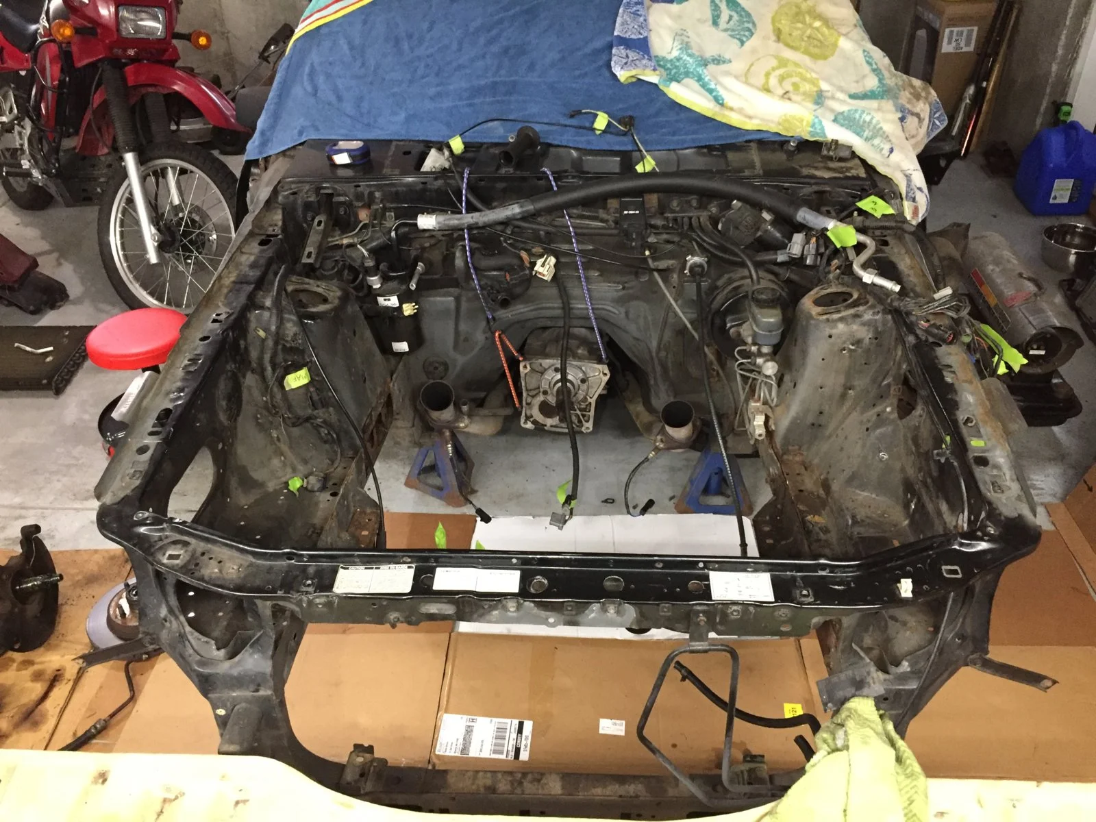

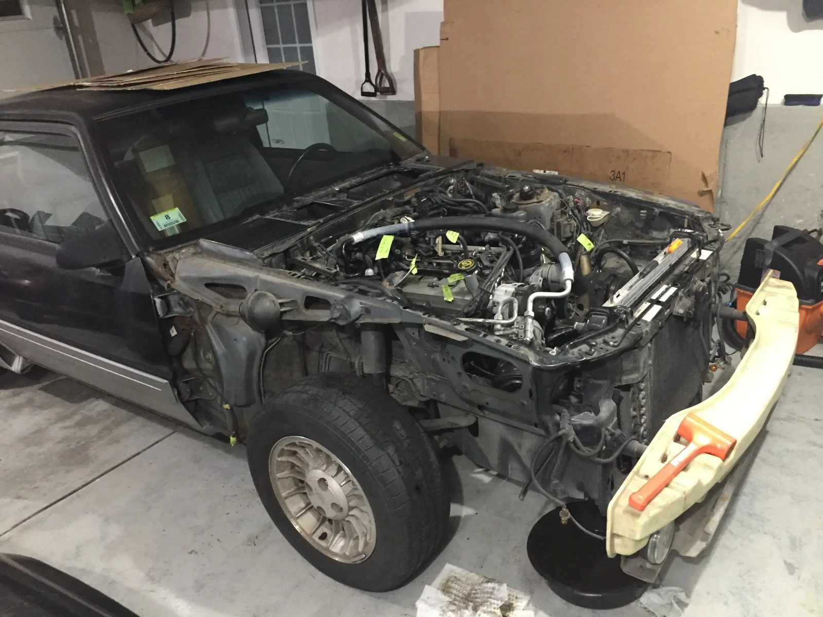

No to quickly get everyone up to speed on where the project currently sits. The patient was prepped for surgery in the middle of January, 2020 with approximately 113k miles. This was the engine bay before any work began.

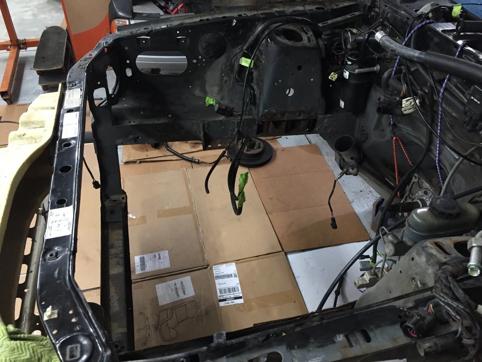

I made good progress with the intent being to pull the engine and finally tackle the strut tower rust that I knew lurked beneath.
This is pretty much what the car looks like today.

1. Any recommendations on engine bay paint? I am keeping it gloss black to match the exterior.
2. Any recommendations on a machine shop in the New England area? I have not dived into the engine yet but I am thinking I want a proper rebuild on it.

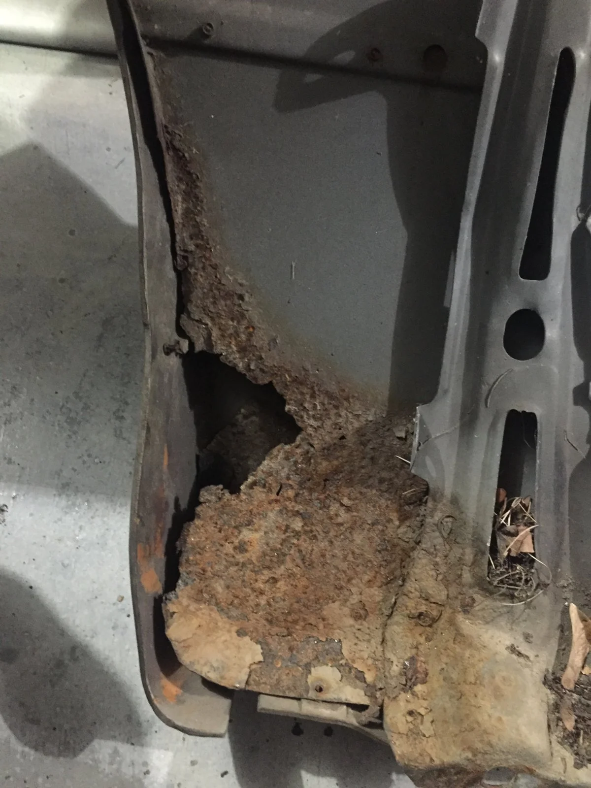

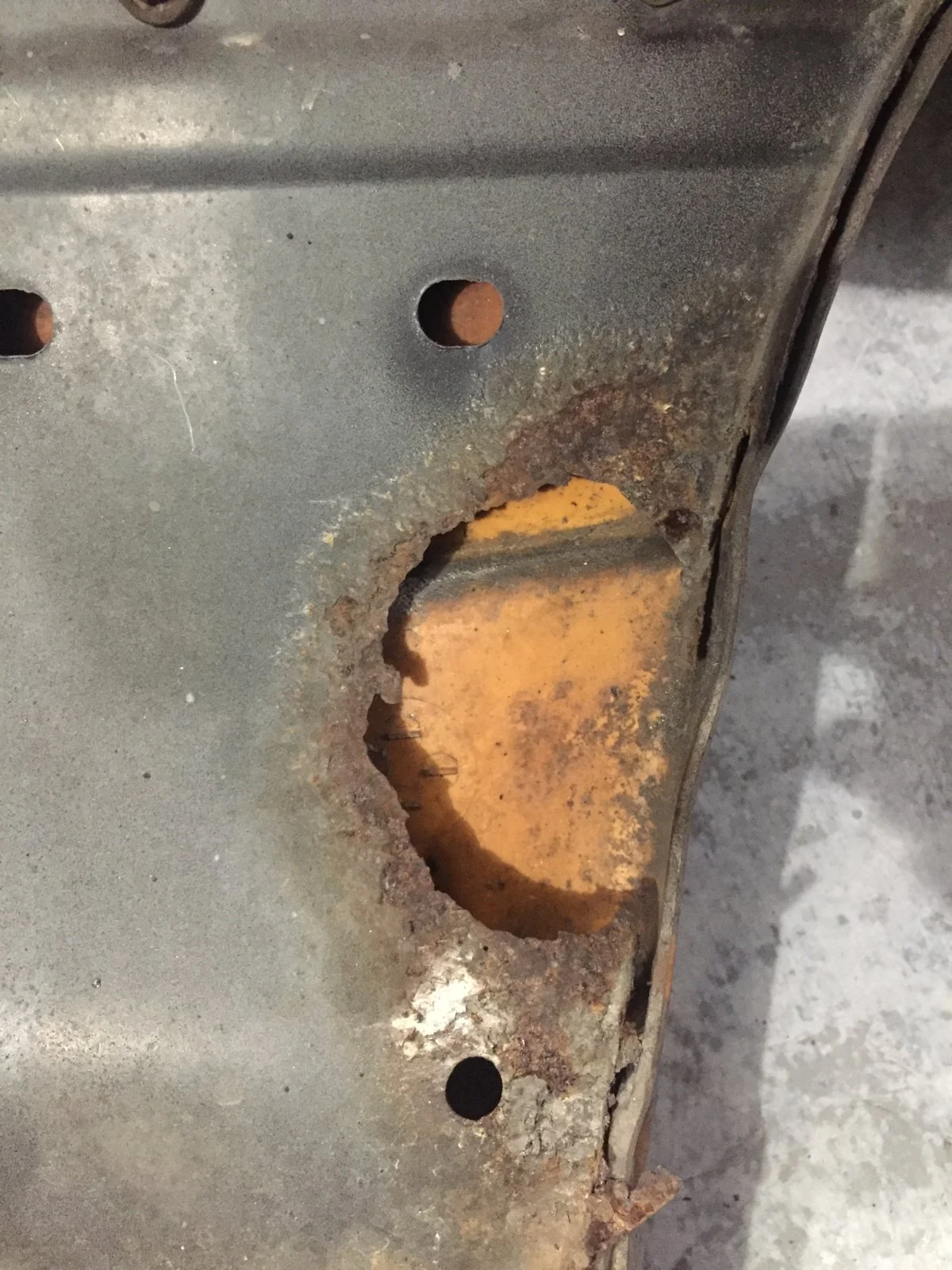

Ouch! It's all fixable and hopefully that is the worst of the rust. Are you going to try to make the repairs yourself or are you going to have a shop do the metal work? I'll be following along.
That's a lot of rust. How do the floors look ?

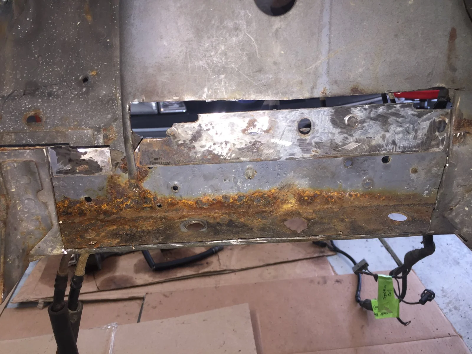

I am going to attempt it myself. Luckily, a lot of the rust is in areas that will mostly be hidden so as long as the repairs are structurally sound, I don't think they need to look perfect. But obviously, I am going to try and do the best job on it that I can.
Repairing that apron and cowl area is going to be a huge undertaking.
I am not as concerned about the apron, but I agree, that corner cowl area is going to be tough. I am not sure exactly how I am going to tackle it yet so for now I am just going to avoid it.
Has your computer ever been rebuilt? There are capacitors on the board that go bad and have to be replaced. It's not a question of if they will go bad but when will they go bad. I would at least pull the computer, pop it open and take a look at the condition. They can be replaced or you can send it out to have it serviced or swapped for a rebuilt one.
There are lots of things that you can do to the car to make it better without going into a crazy mod fest. It's easy to get carried away with upgrades though, so be careful. It's an addiction I tell ya! I'm really interested to see where you want to take this car. Maybe lay out a little more specifically what your end goals are. I know you want to keep it mostly stock, but there are just so many things you could tackle. Especially if the car has never been gone through. I would recommend going through the entire suspension and upgrade worn out parts. Bushing, shocks, tie rod ends. All that kinda stuff!

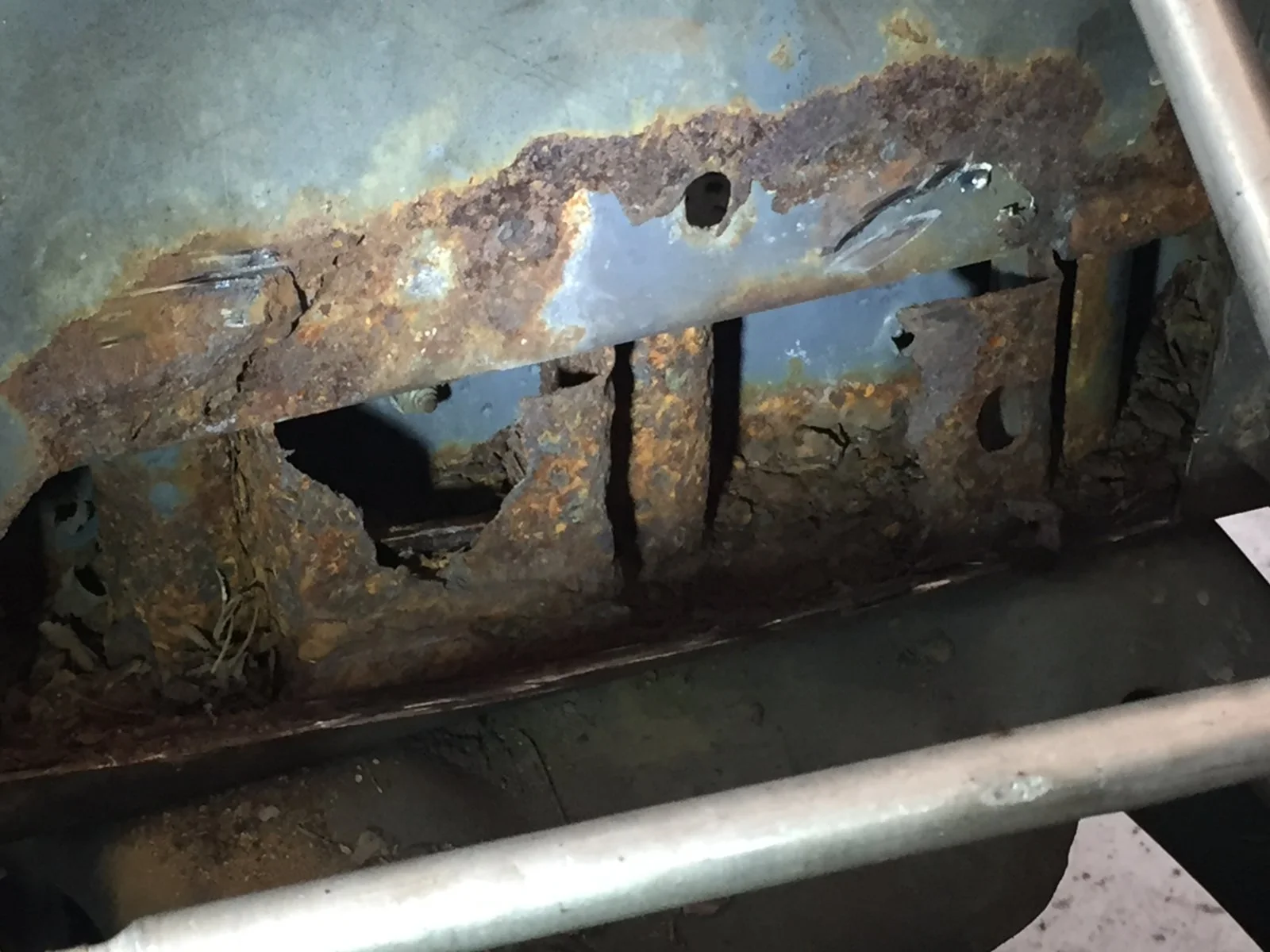

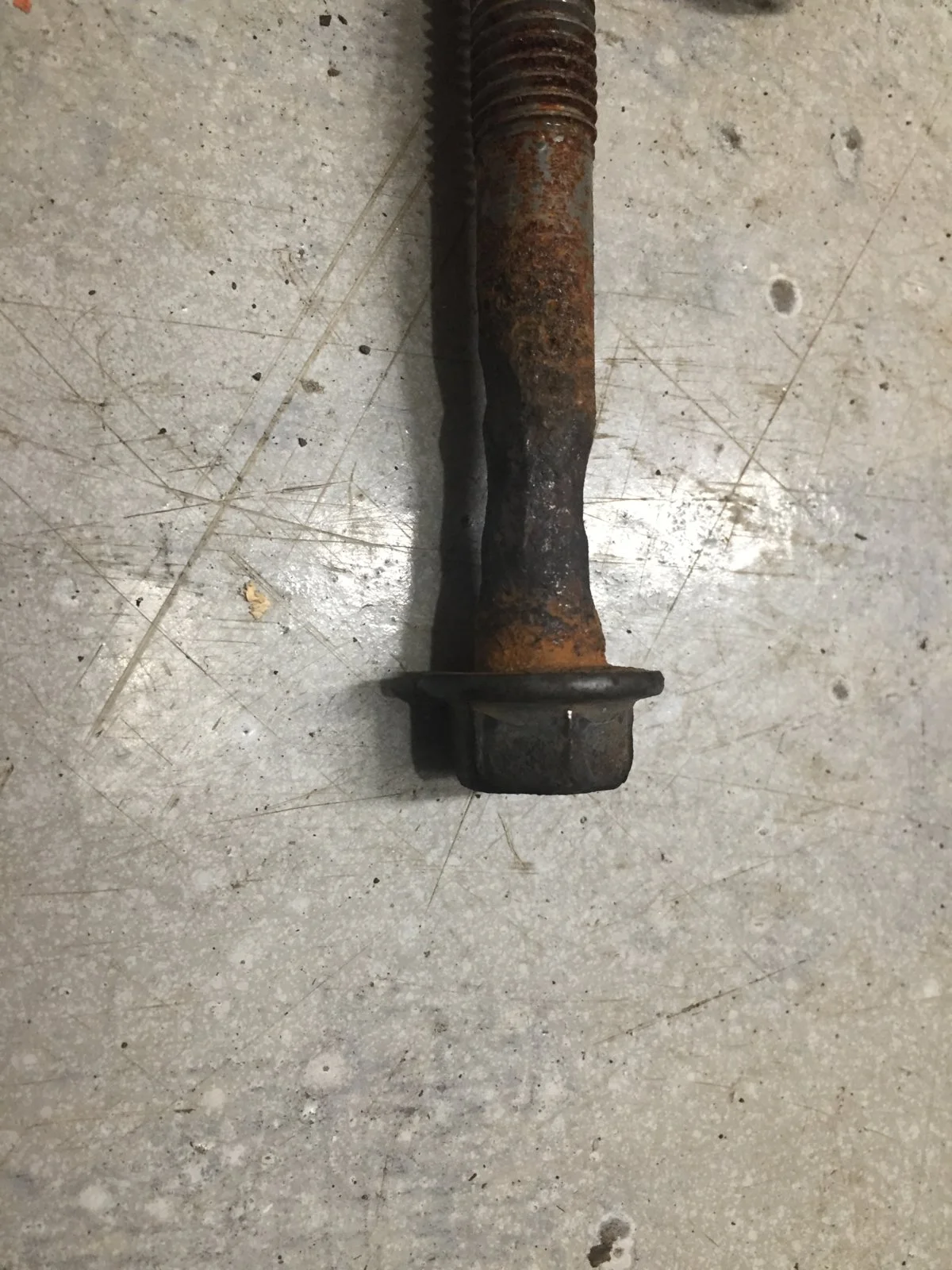

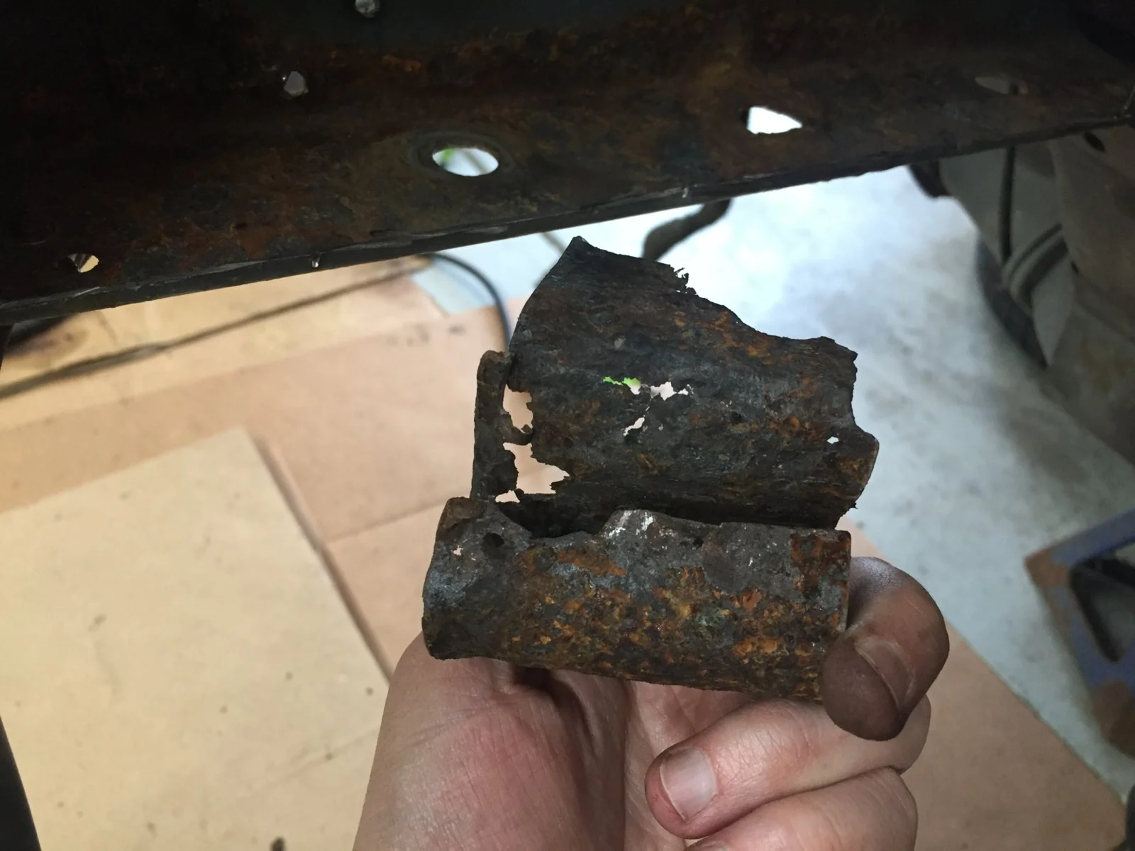

Got in the garage yesterday and made some progress on removing the bad metal. Used a spot weld cutter to cut the strut tower to the top plate of the crush tubes. With that removed the crush tubes then pretty much fell out. They were in pretty nasty shape. The reinforcement plate on the bottom of the frame rail pretty much fell out as well. Not sure if these were supposed to be welded in or not.

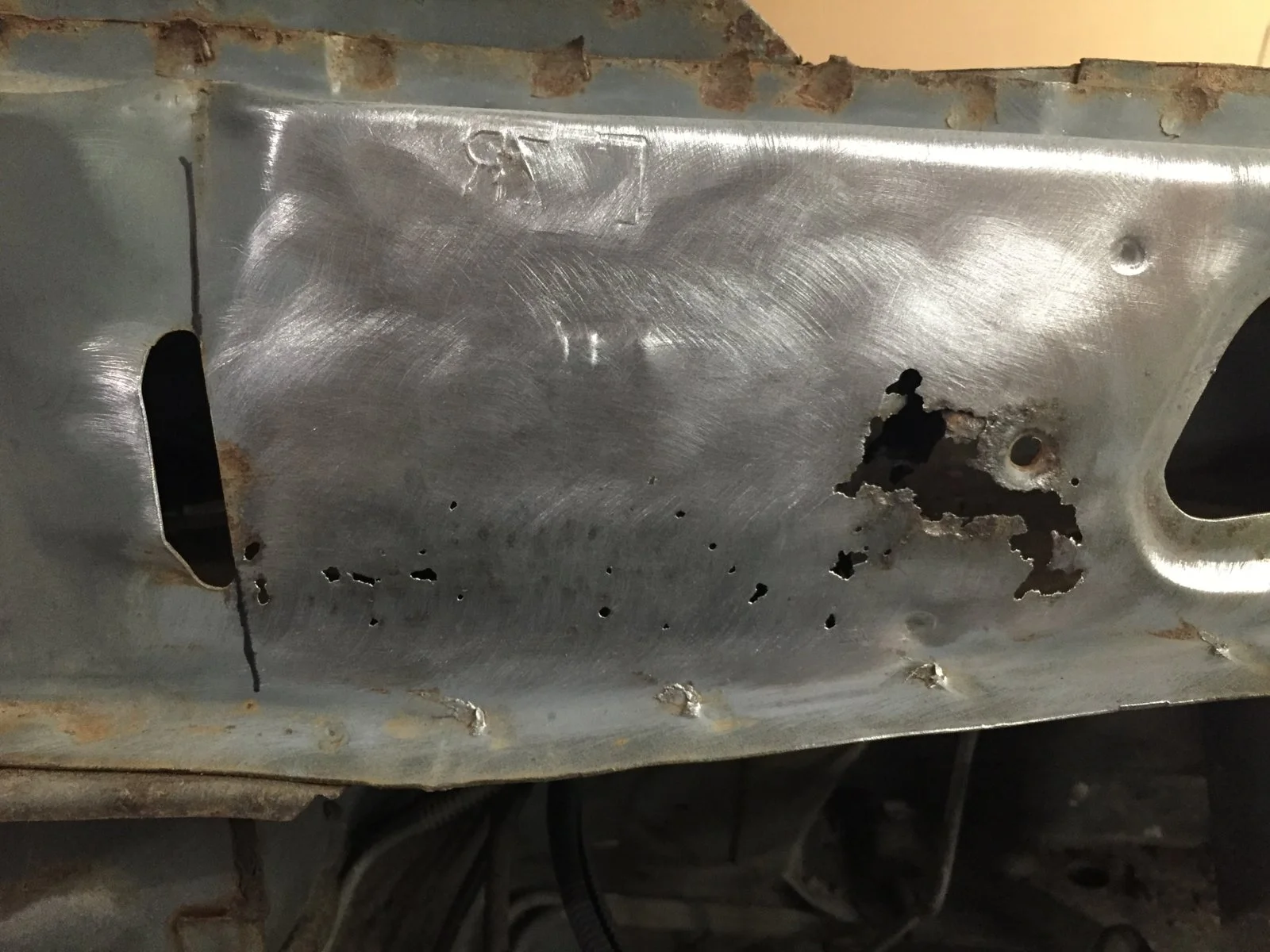

Once cleaned out I then wire wheeled the frame rail. As you can seen in the image, the area around the drain hole (center) was quite thin and I found a few pin holes as well. As a result, I am thinking that the bottom of the frame rail will need to be cut and a replacement fabricated. That would then be welded in along with a new reinforcement plate and some new crush tubes.

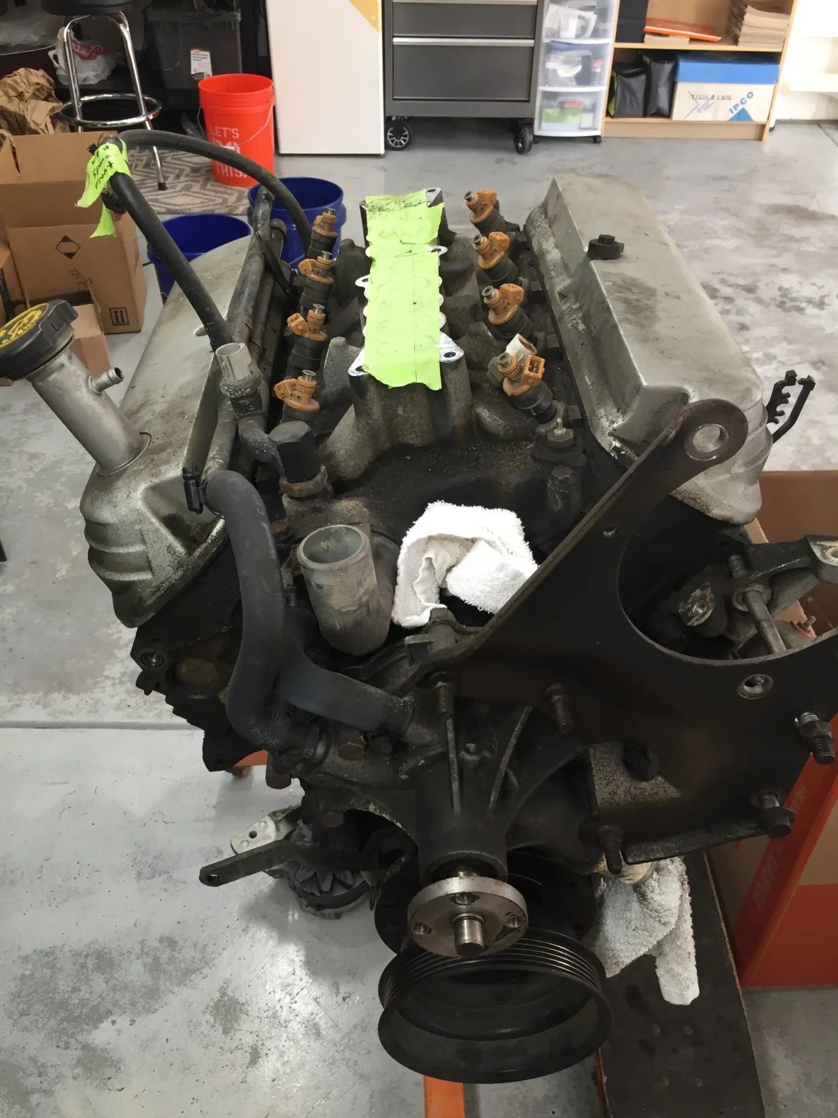

Also started to tear down the engine. Didn't get too far but started to remove all the accessories, etc.

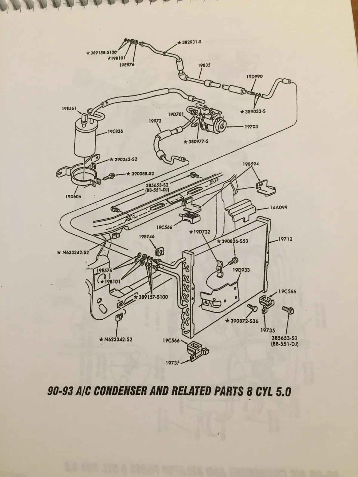

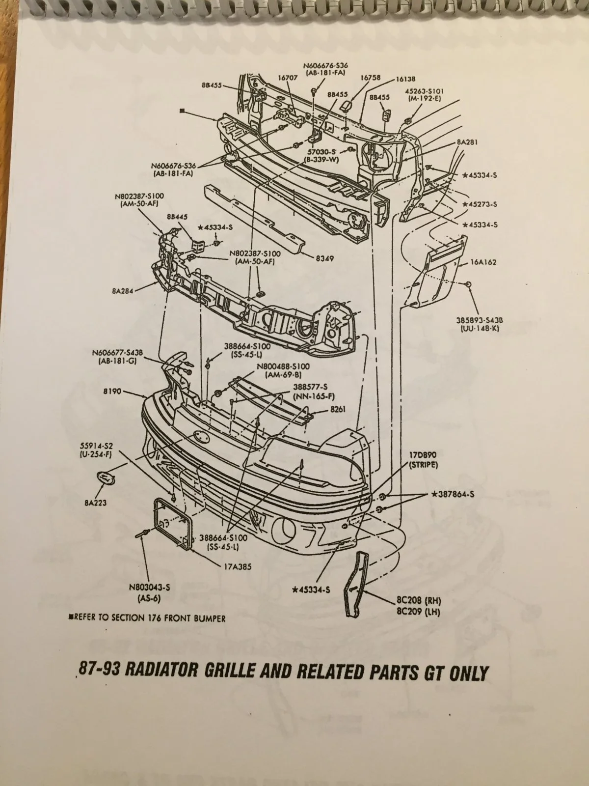

Lastly, wanted to show everyone this book I had picked up a while back. Got it at Mustangs Unlimited when they were going out of business. Thinking it was <$20 with the original price being closer to $50. Lots of diagrams showing the major systems in the car, scan quality is not always the best and it definitely helps if you are familiar with the system. But for the price, it is a great reference and should aid me (along with my pictures) when the car goes back together. Pic of a couple examples below.
