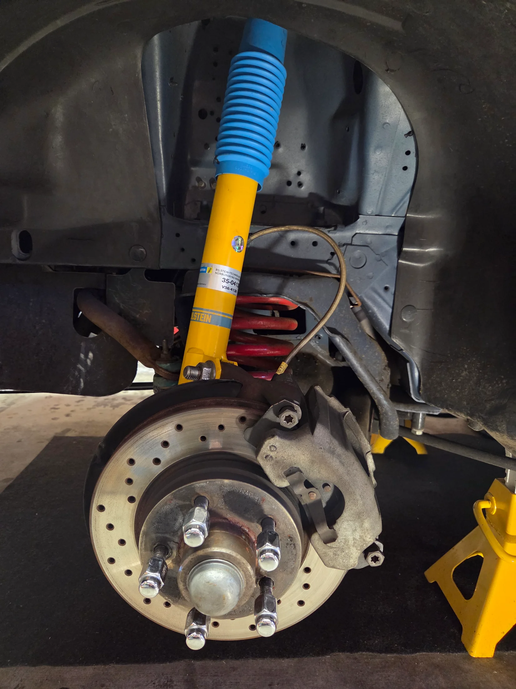

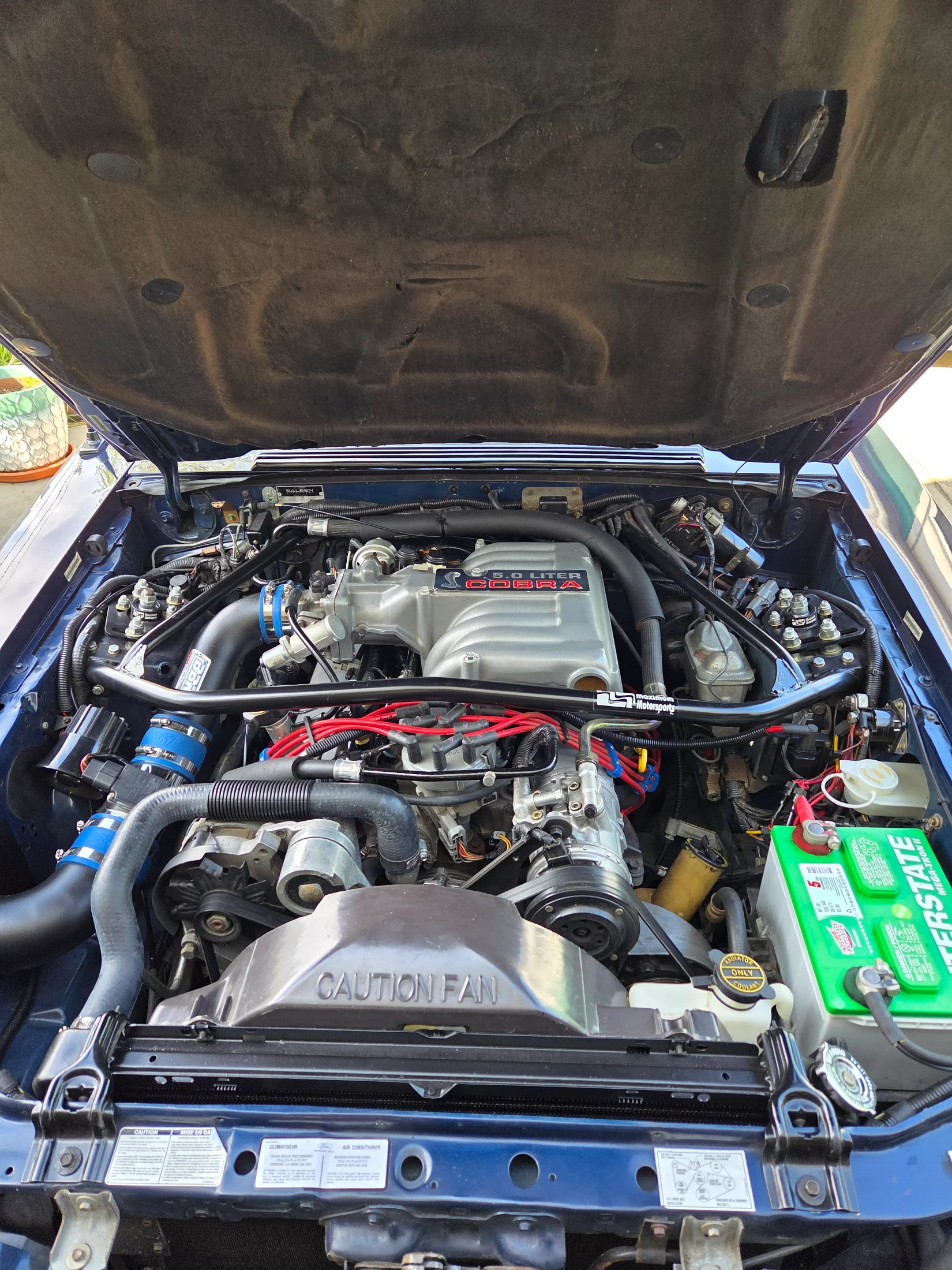

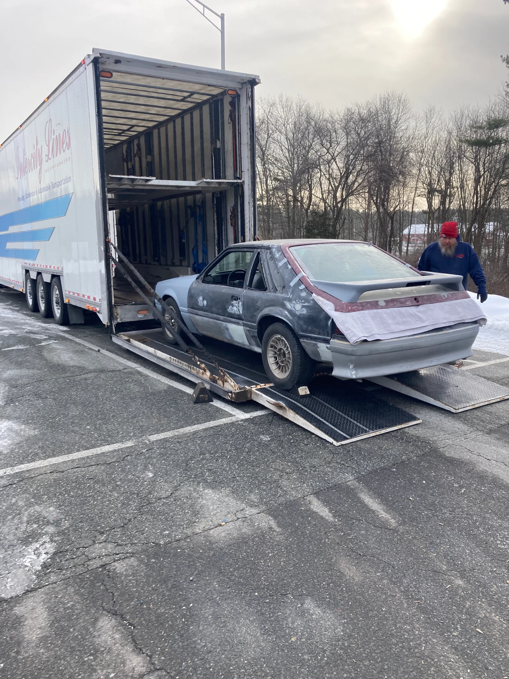

How was the cross country trip with a blown apart car - or was it back together again?
How did the passenger side cowl (below the windshield) turn out? Any further rust down the framing for the door mounts?

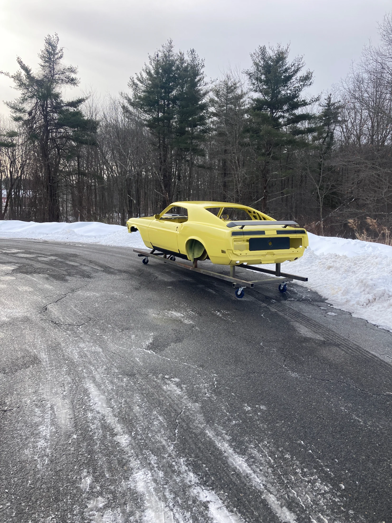

Car was mostly together for the trip across the country. Although the hatch was only duct taped on, and the fenders had only a few bolts in. It didn't run great, only enough to start it and drive it on/off the trailer. I also transported the shell of another mustang I am working on at the same time. That one needed to be pushed up by a few people into the trailer.
I used Intercity Lines (https://intercitylines.com/) for both of these cars as well as getting our daily drivers across. The cost of their enclosed transport was quite a bit more (~$3000 v ~$1000-$1500) than an open carrier but worth it to keep them protected. Intercity also has some agreement with exclusive drivers and/or owns their trailers. Point being - they don't subcontract the transport out to a fly by a night operator. More cost but I felt better about moving these cars. No idea what costs are these days as it seemed their quotes fluctuated depending on fuel prices. Took about a week-ish to go from New England to CA.

FatFoxx installs right on the core support. Nice neat installation.
