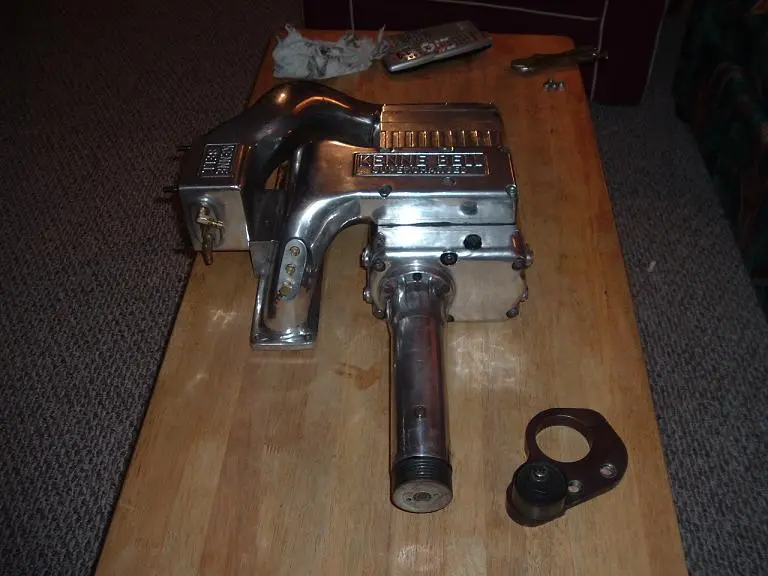

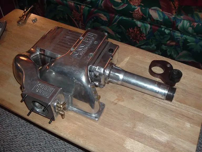

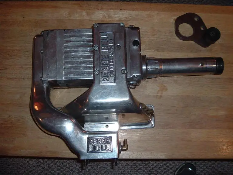

the kb takes a stock lower, the explorer lower has different bolt pattern. plus, the holley lower most likely flows better than an explorer lower. as to the heads, mine were ported by "thumper" http://www.thumperoforangepark.com and they are supposed to flow better than gt-40s
with a kb at 10# boost you'd probably make somewhere around 350 at the wheels
it bolts directly onto the lower intake, couldn't be simpler.
