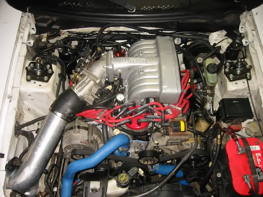

When I fired my motor for the first time this year my idle was nearly spot on as well. The only problems I had was if you spike the throttle, when the rpms fall it would search alittle. Once it found 900rpms, it will stay rock solid. Still have alot of tuning to do as well but for some reason my WB is not reading through the tweecer anymore. Have to look into that but good luck with the tuning, thats the best part.
Here are a couple pics, if you see im not much of a blinger. Im for sure just about form and function.
Me with the engine on its way in
Engine in and all hooked up
