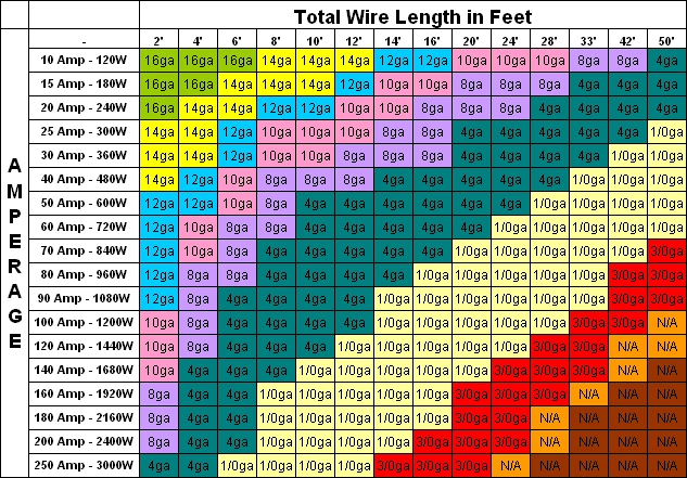

Then, run a 2nd wire from alt power stud to starter solenoid. You'll want a slow-blow fuse rated slightly under the wires max capacity. Gonna look up what that is
Edit: here ya go. Prob need a 125a slow blow fuse
