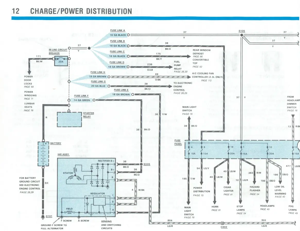

You'll want to check wire 38 and 36 to see if the fusible links are OK and you have power on these wires.

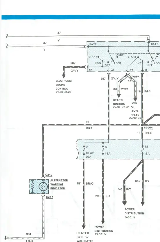

Wire 904 runs to the cluster to the BATT warning light. Often if folks put LED's in here, it causes charging issues.
