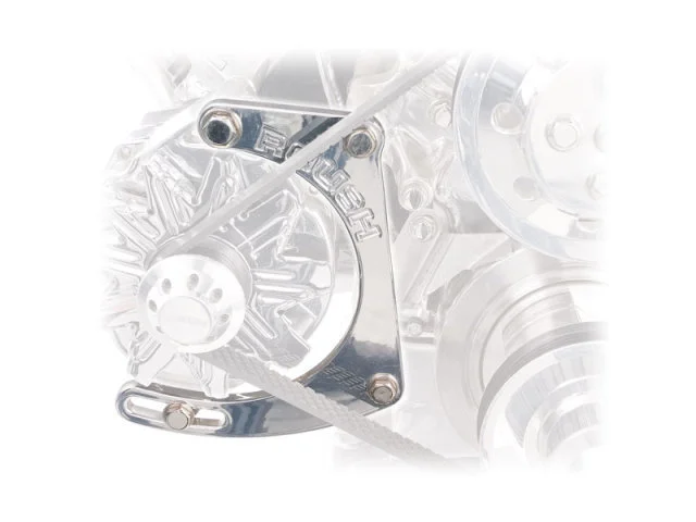

My alternator went bad on my mustang and it has the Roush Billet alternator bracket I went to Orielly's with the bad alternator and they cross refrenced it and sold me a reman alternator. I put it on and it fit perfect but didn't work(only put out 11.49v at the output post). I took it back and the exchanged it for another reman, I intalled that one and it had the same issue. I decided to order a brand new one form summit so I returned the second bad one to Oreilly's but they had already sent my core off. So I get the gm one wire alternator that I was assured would work by roush. And it didn't fit, the lower tab was off by half a inch. I called roush again and they told me to order a power master and it would work. After doing more research I found a power master part number which is 8002 rr but they don't sell it anymore :-( I need a 140 amp that works with it. Any help would be appreciated

Only uses one wire and it is a 4 Gauge wire and it worked fine on the original alternator. It goes from positive terminal of battery and is ran under the bumper with zip ties and wire loom then comes out by passenger side right next to the alternator. Don't think thats the problem but i'll double check to make sure it is not grounding out anywhere
