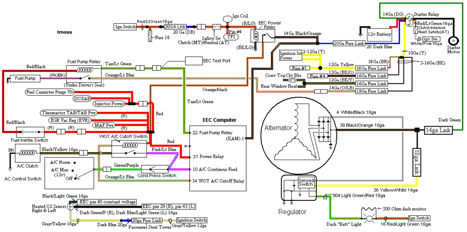

At some point the alternator is either losing the sense voltage that it uses to
regulate the output or is losing ground that connects it to load.
The secondary power ground is between the back of the intake manifold and the
driver's side firewall. It is often missing or loose. It supplies ground for the
alternator, A/C compressor clutch and other electrical accessories such as the
gauges. Any car that has a 3G alternator needs a 4 gauge ground wire running
from the block to the chassis ground where the battery pigtail ground connects.
See the following website for some help from Tmoss (diagram designer)
& Stang&2Birds (website host) for help on 88-90 wiring
http://www.veryuseful.com/mustang/tech/engine/images/88-91eecPinout.gif
Diagram courtesy of Tmoss and Stang&2birds.

BTW i just added a ground from my block to the chassis and it made a huge difference in the voltage reading. Even with the stock alt i can tell its much better. I just need to buy a new regulator, does anyone know where to get regulators for the 3G alternator? I remember someone had posted this link before, but it was a long time ago. They run around 35$ if i remember correctly. I could use one...
