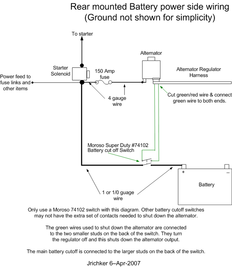

Follow this guide, courtesy jrichker
jrichkerStangNet's favorite TOOL
SN Certified Technician
The following cut off switch is a requirement for most drag strips...
For a battery cut off switch, see http://www.moroso.com/catalog/categorydisplay.asp?catcode=42225
is the switch http://www.moroso.com/catalog/images/74102_inst.pdf is the installation instructions.
Use the super duty switch and the following tech note to wire it and you will
be good to go.
Use the Moroso plan for the alternator wiring and you risk a fire. The 10 gauge wire they recommend is even less adequate that the stock Mustang wiring.
There is a solution, but it will require about 40' of 18 gauge green wire.
Wire the battery to the two 1/2" posts as shown in the diagram.
The alternator requires a different approach. On the small alternator plug there is a green wire. It is the sense lead that turns the regulator on when the ignition switch is in the run position. Cut the green wire and solder the 40' of green wire between the two pieces. Use some heat shrink to cover the splices. See http://fordfuelinjection.com/?p=7 for some excellent help on soldering & using heat shrink tubing.
Run the green wire back to the Moroso switch and cut off the excess wire. Try to run the green wire inside the car and protect it from getting cut or chaffed. Crimp a 18 gauge ring terminal (red is 18 gauge color code for the crimp on terminals) on each wire. Bolt one ring terminal to each of the 3/16" studs. Do not add the jumper between the 1/2" stud and the 3/16" stud as shown it the
Moroso diagram.
How it works:
The green wire is the ignition on sense feed to the regulator. It supplies a turn on signal to the regulator when the ignition switch is in the Run position. Turn the Moroso switch to off, and the sense voltage goes away, the voltage regulator shuts off and the alternator quits making power.
The fuse & wiring in the following diagram are for a 3G alternator. The stock alternator uses a dark green fuse link wire that connects to 2 black/orange wires. Always leave them connected to the starter solenoid even if you have a 3G alternator.
Rear mounted battery ground wiring. Follow this plan and you will have zero
