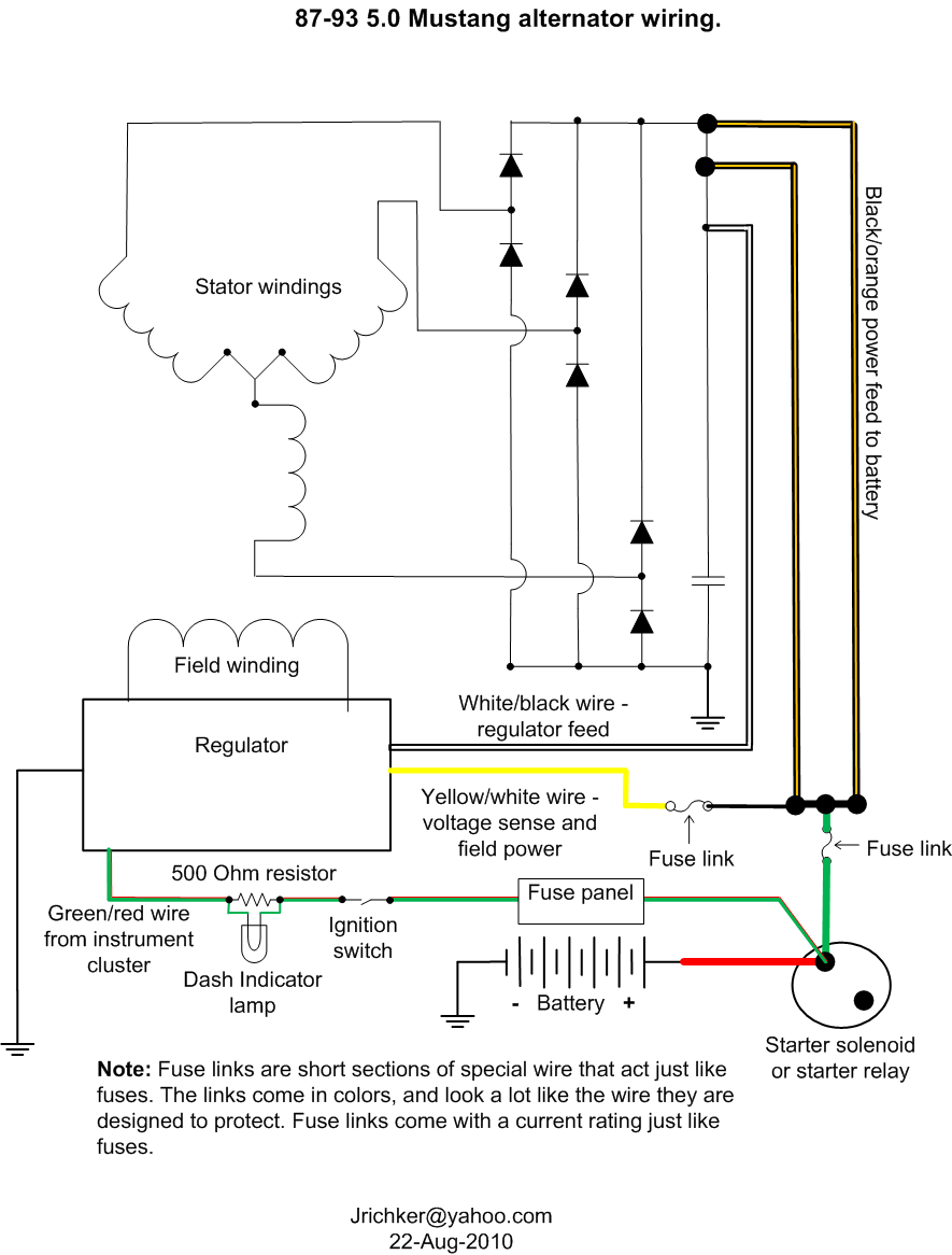

@BOSSC351
BOSSC351 said:
That signal wire comes out of the single connector recepticle at the back of the alternator and goes down with with the black/orange wires and is bundled in harness wrap then goes straight back to the alternator in the center pin of the 3 wire connector. I found where the black/orange comes out by the solenoid. it goes in to a rubber junction marked p13 along with a brown? wire and comes out as a green wire to the solenoid. There is no continuity there between the signal wire and the green wire. Now there is between the light green/red in the 3 wire connector and the green wire at the solenoid.
Check out the diagram below of the alternator. The yellow/white wire goes to a fuse link that connects to the black/orange wire.

Alternator wiring circuit
Notice the green wire connects to a switched power source. The circuit contains a 500 ohm resistor in series between the switched power and the alternator. Connecting it to switched power keeps the regulator from drawing current when the engine is not running. The resistor limits the current flowing through the wire so that a fuse isn't needed if the wire shorts to ground.
Also notice the sense wire connects to the starter solenoid and it is fused. It connects to the starter solenoid so that it can "sense" the voltage drop across the output wiring from the alternator.
