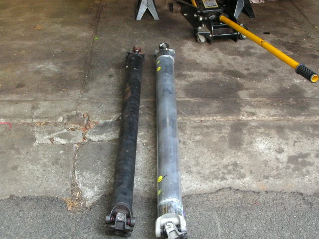

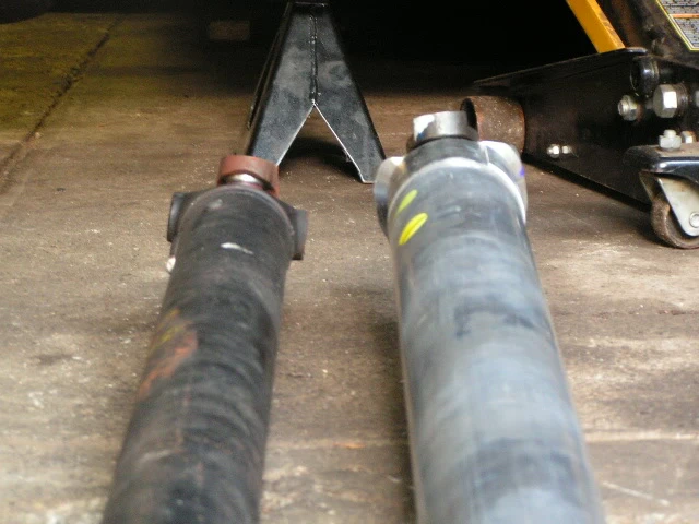

The main reason as said above is to eliminate vibration, BTW those paint dots you see in the Pic get matched up with the mark on the companion flange and the torque on the new bolts with yellow loctite is 71-95 Ft Lbs
