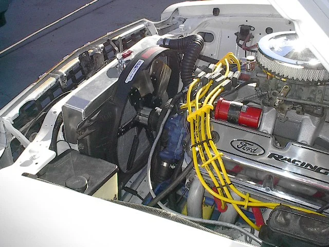

I had Ron Davis Radiator build mine, I know they still have the template for it. If I remember it was around 300, On the spendy side but worth it. Cools the 351W like a charm even during parades in July! :)
Ron Davis aluminum radiators for racing, offroad, performance street car, and other custom applications
