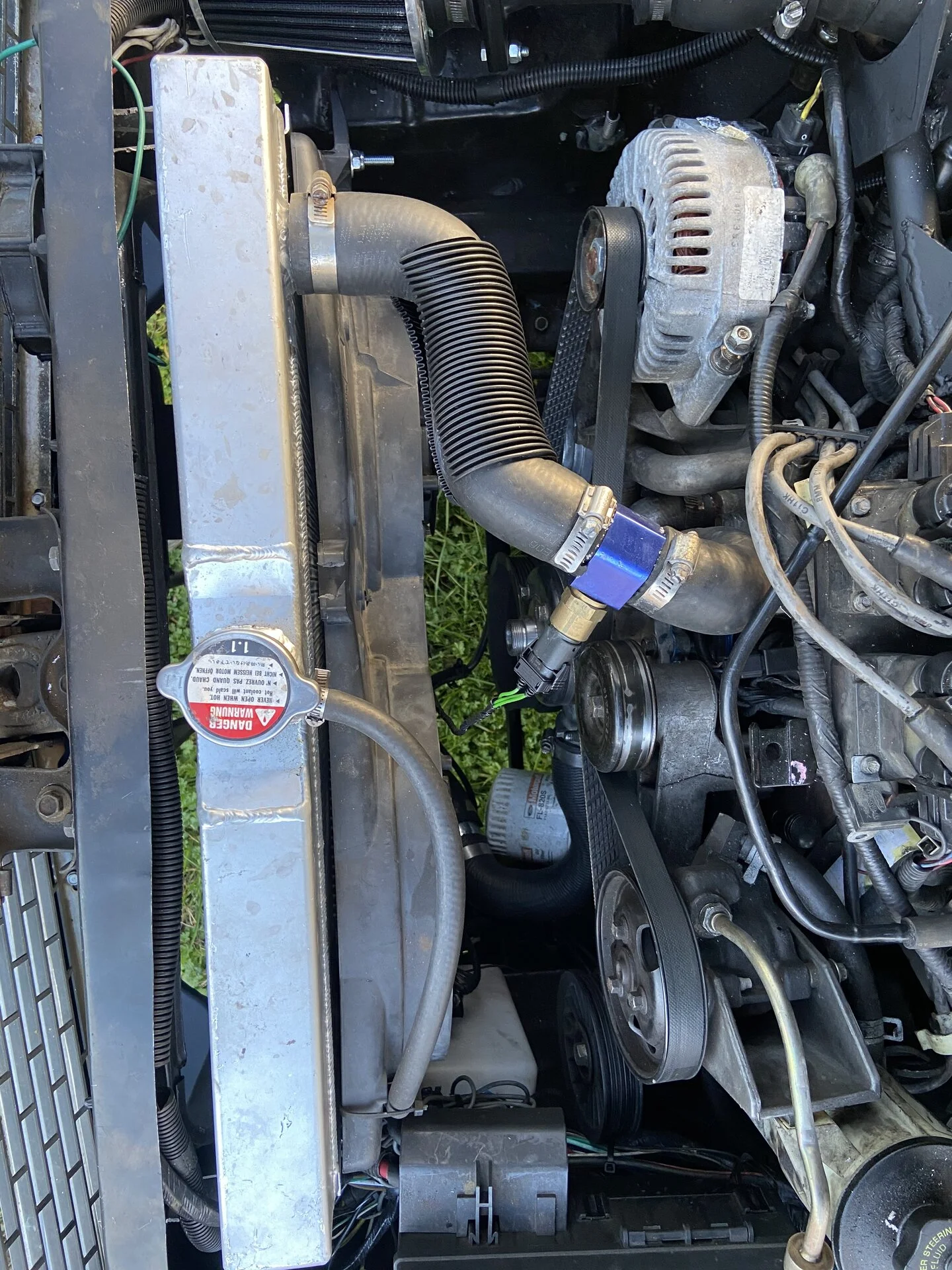

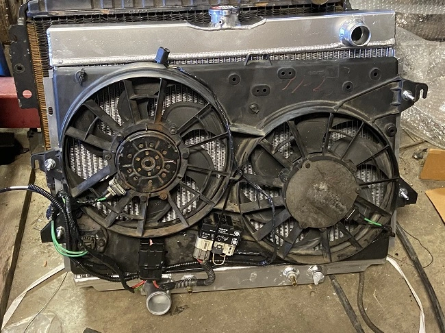

I have a '66 but I put a '67 BB radiator in mine. 2000 Contour/Cougar dual fans fit that one great. I cut the opening in the core support to use the larger radiator though. If you kept the original width then they will be too wide. A single '93 Taurus fan may be able to be cut down to fit. They are awesome fans. Picture shows my installation. I have a 5.0 with Explorer accessories so I have more room but you can get an idea of how compact the Contour fans are. Coupled with a BMW temperature switch and Volvo relay you can have a really nice 2-speed fan setup.
