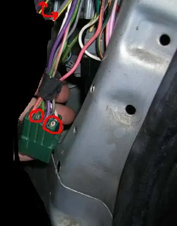

I initially had no fuel pump power, so I did this change that you see in this picture
I beleive this allows the fuel pump power to skip the engine harness entirely...
however; later I found teh real problem was that the power wire for hte eec relay circuit caused no power to most systems in the car and I fixed that..so later I put the wires back to the stock version on the fuel pump thinking it would have worked if this circuit had power upfront...and since changing it back it worked fine the stock way.

k, so thinking the connectors was the problem, we twisted the wires together back the way we had them when we first finished the swap...only so I could drive it today.
later, we soldered the wires together back to the stock method...and guess what...same problem.
so it wasn't the connectors...
I had to drop the car off to a tranny shop for a tranny rebuild tonight so we (my boyfriend and I) decided to leave it the modified way so it would be relabile to start it.
...guess I'll need to figure out what's going on later by reviewing the wiring diagrams and see what's being bypassed when we splice it using the chassis wiring. I wish it stayed working the stock way because the modified way I think the pump runs longer or more often than it should and I don't like it
