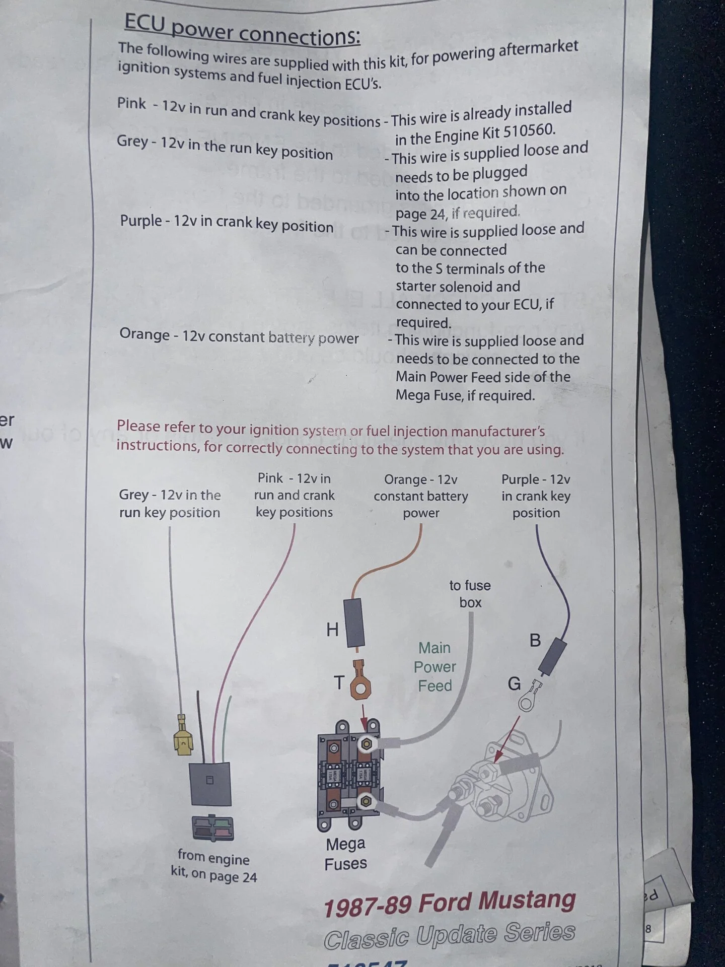

1 1LoneFox New Member Jun 25, 2022 3 0 1 Tennessee Jun 25, 2022 #1 Jun 25, 2022 #1 Does anybody know how to do the ecu hook up because I’m stuck there My fox is 89 mustang gt 5speed ecu is A9L Attachments image.webp 227.6 KB · Views: 126
