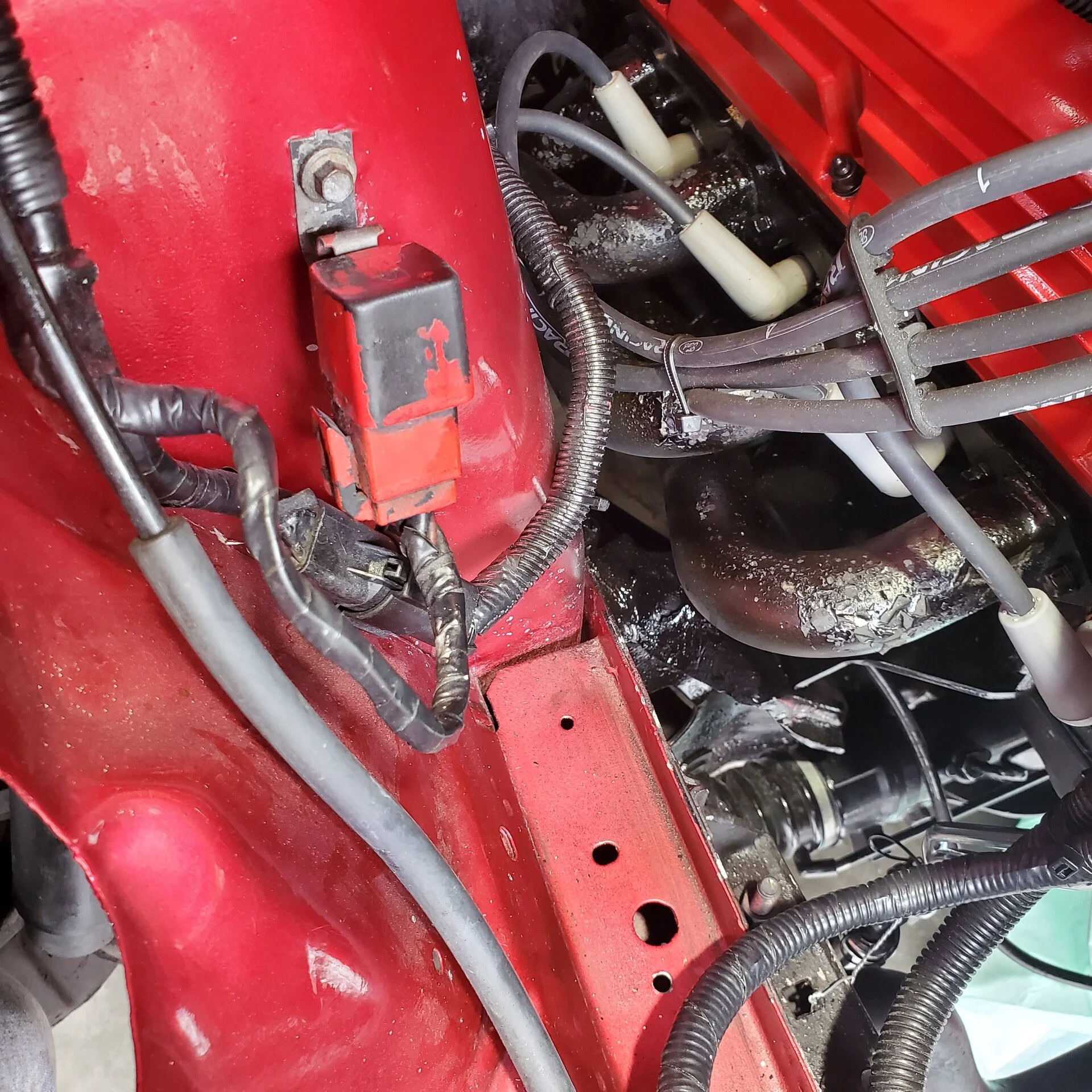

I figured it out guys. The car has an external voltage regualtor for the old alternator on the passenger side of the engine bay at the top. It's a small metal box with a harness plugged into it. I unplugged it and bingo amp light is off. So now I can get rid of that ugly box from the engine bay and clean up some of the wiring. It's a bit of a rats nest right now.
Is this the box you're talking about? I'm having the same issue.
