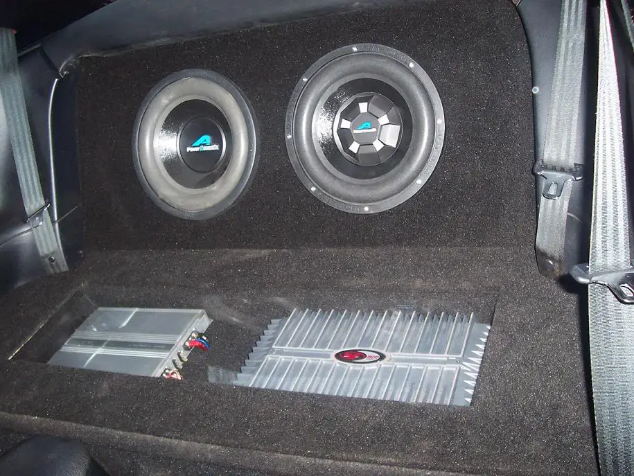

This is where i put mine :hail2: :hail2: :hail2:
My amp is mounted to a board then attached to the trunk side and floor securely to prevent movement
I drilled a new hole in the trunk floor and then sanded off the paint for the ground wire to mount to
Here's mine
