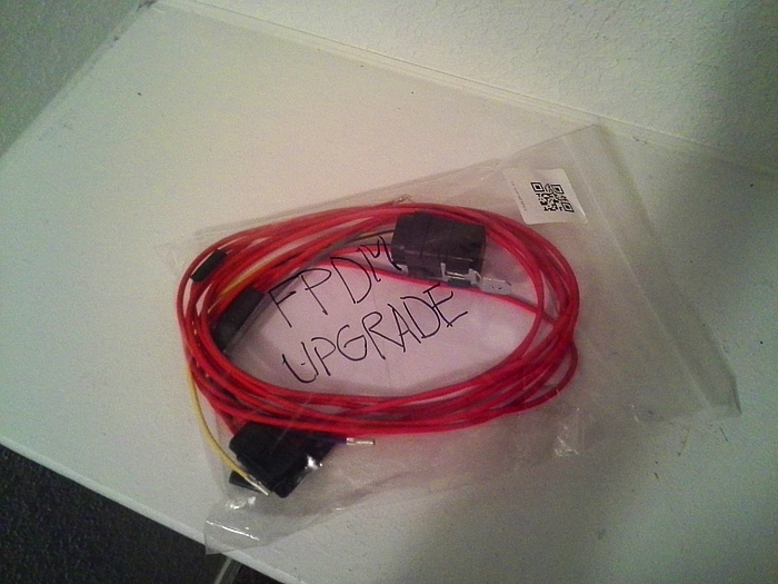

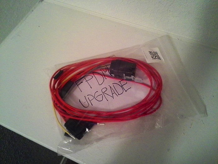

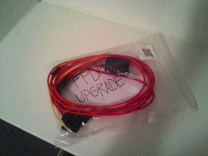

BAP/FPM wiring upgrade

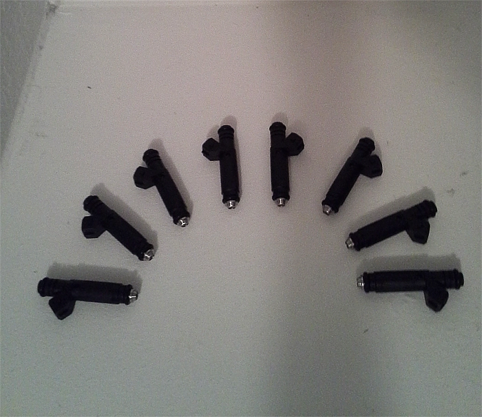

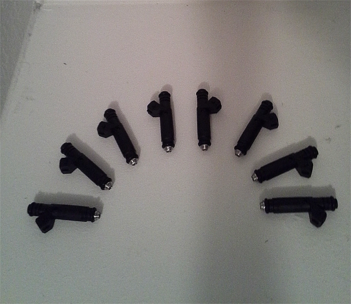

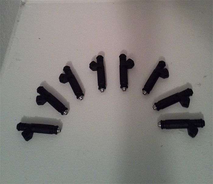

60lb injectors

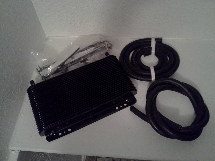

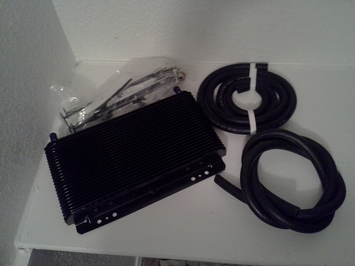

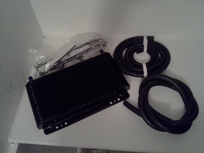

Aux trans cooler (to cool that 3000 stall)

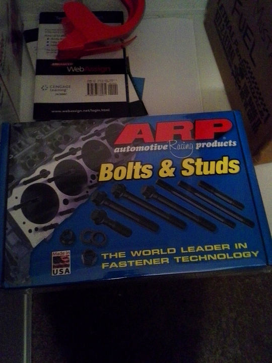

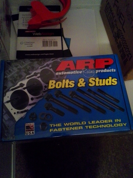

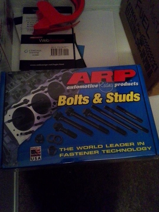

ARP hardware :cool:

Very nice! 60's should give you room to grow, especially if you add a meth kit to fuel the beast in the future. Have you decided what you're going to do gear wise?
