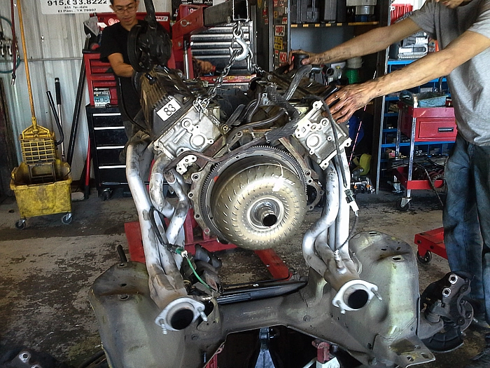

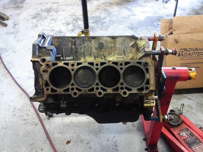

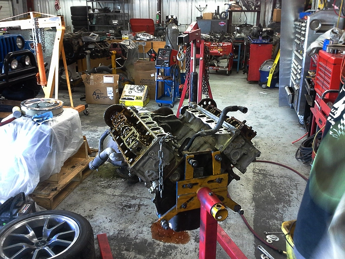

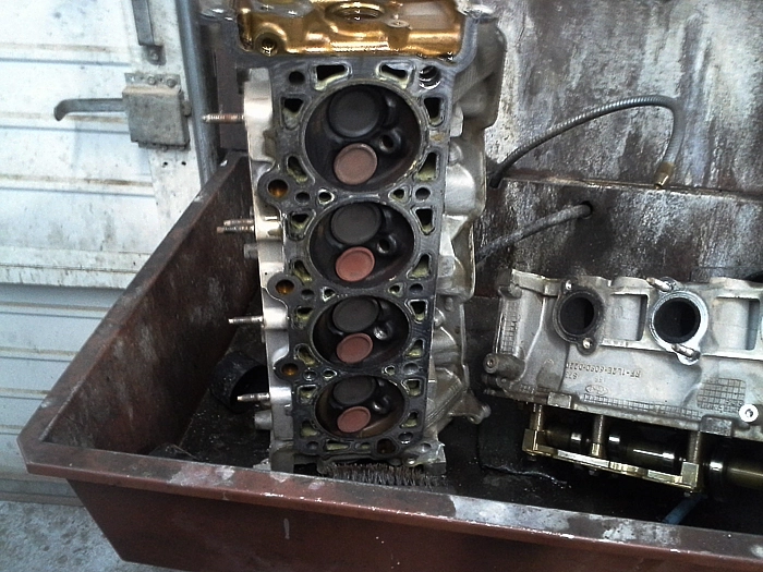

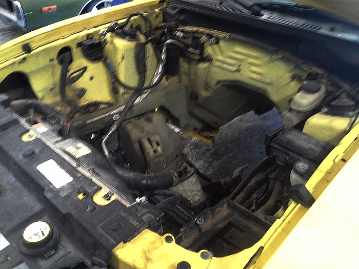

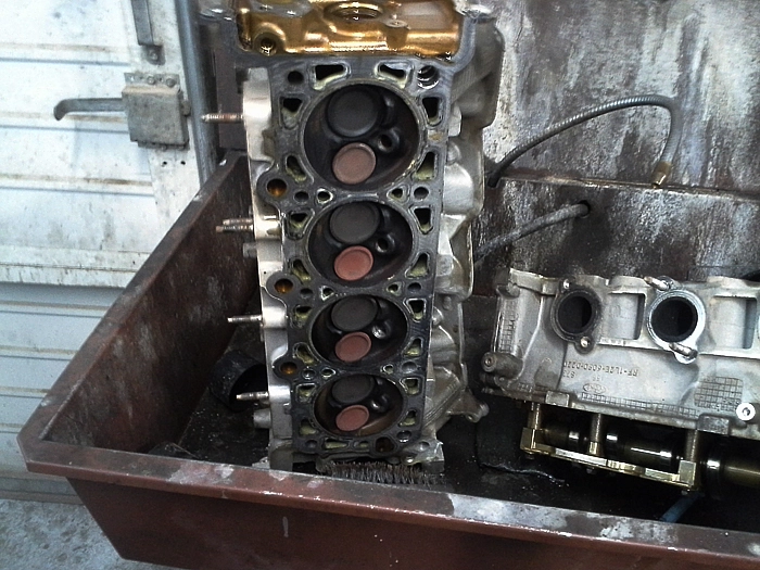

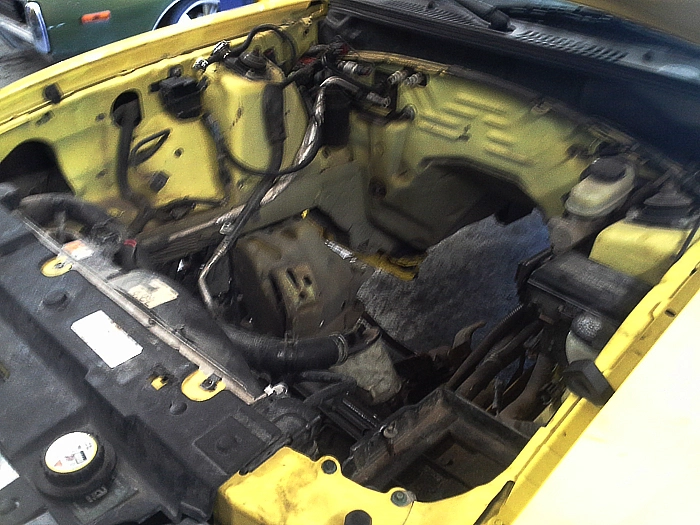

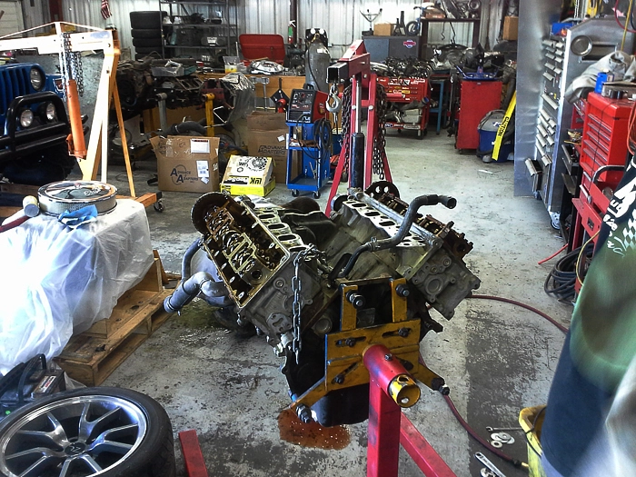

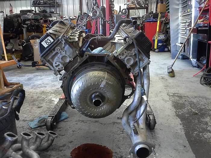

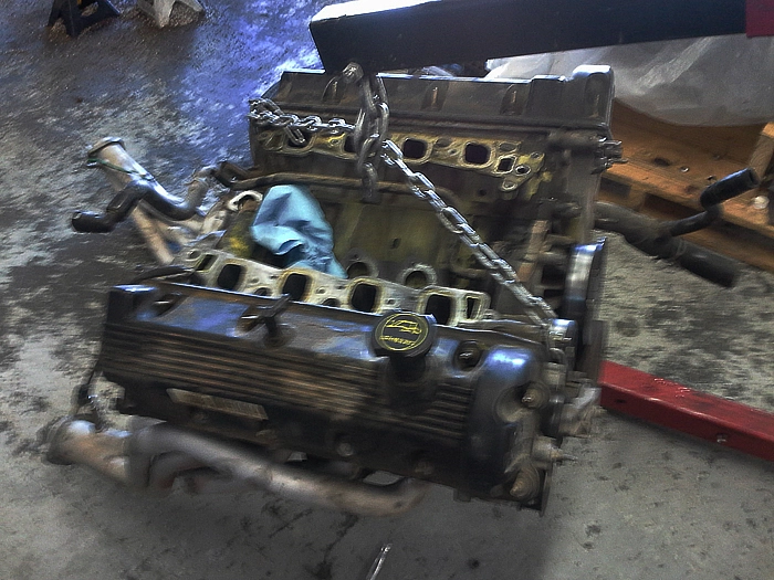

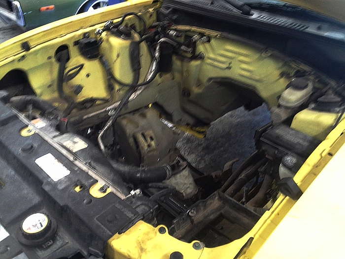

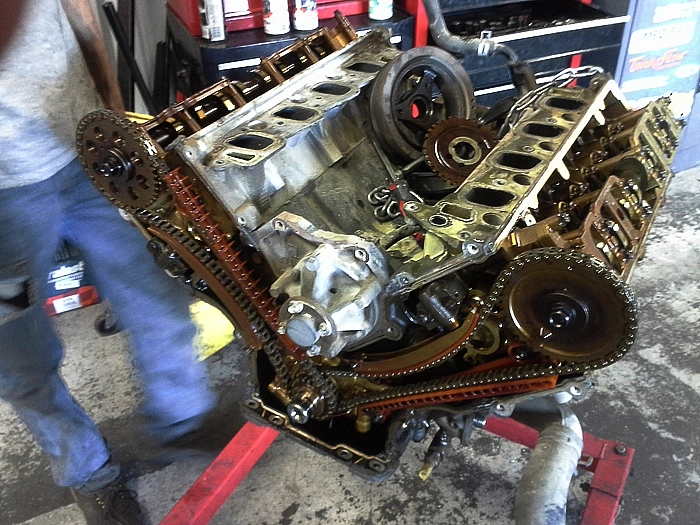

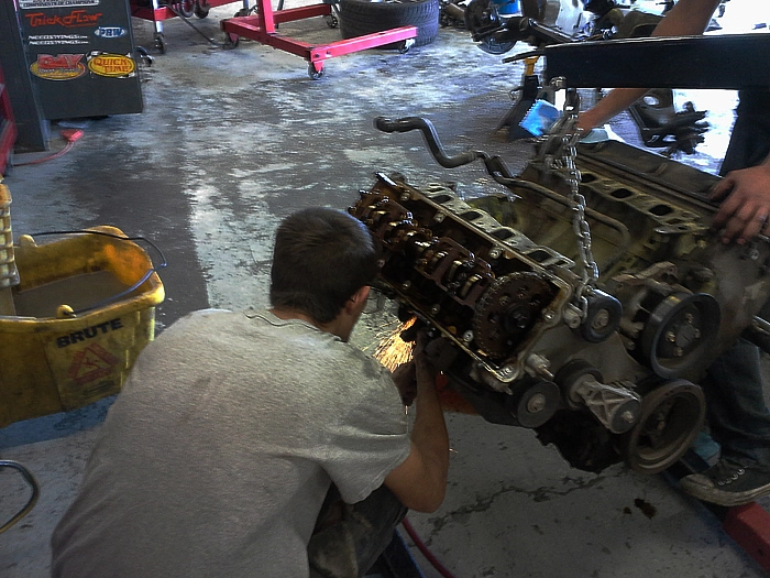

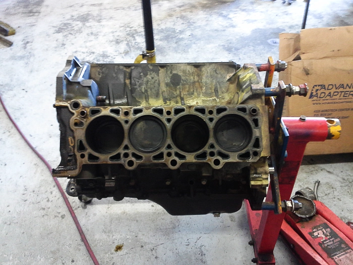

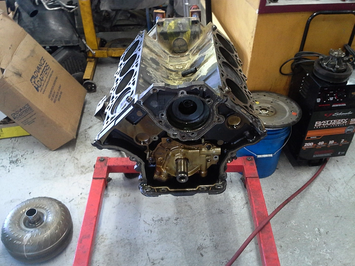

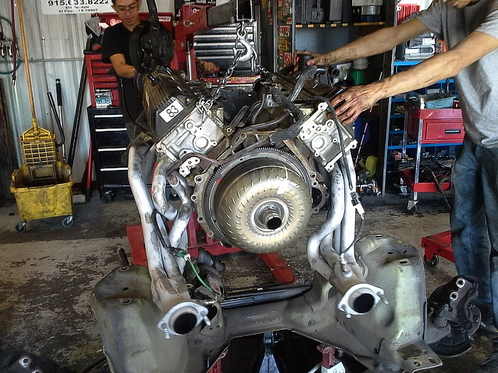

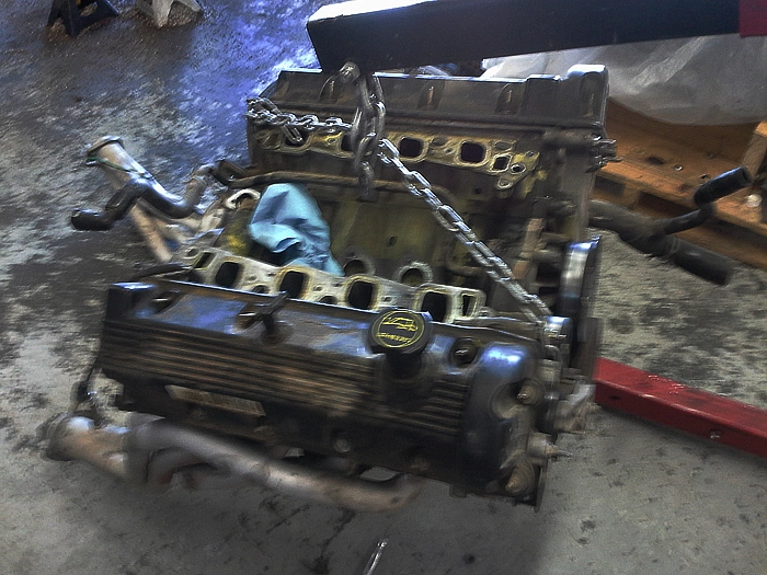

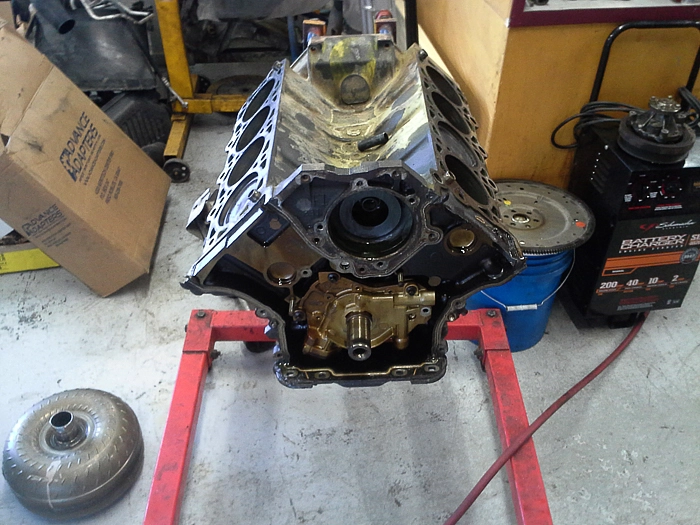

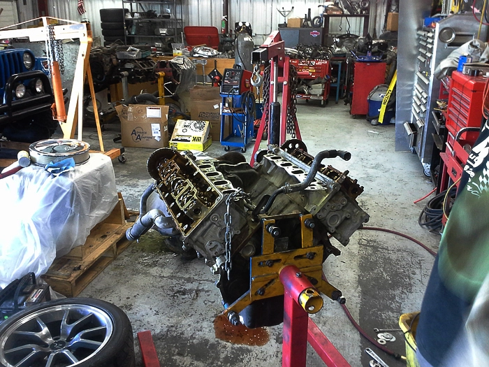

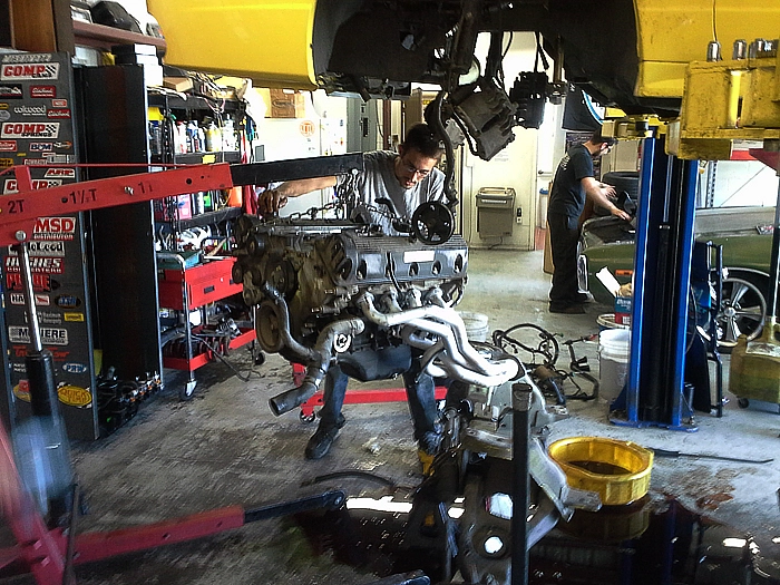

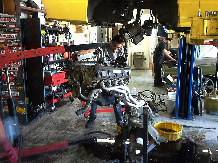

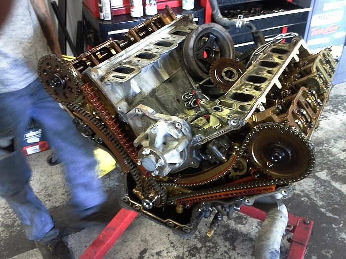

Finally got around to uploading some pics, for now.....

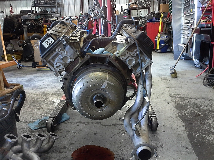

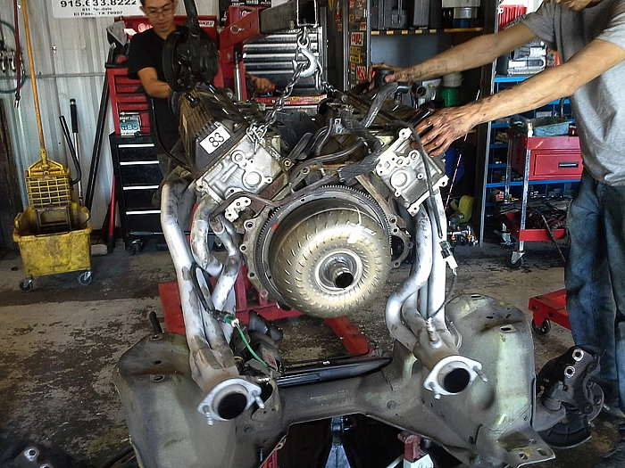

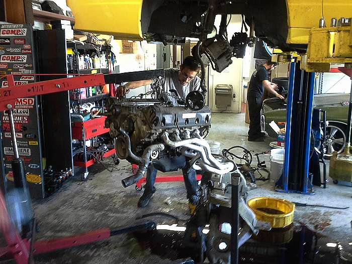

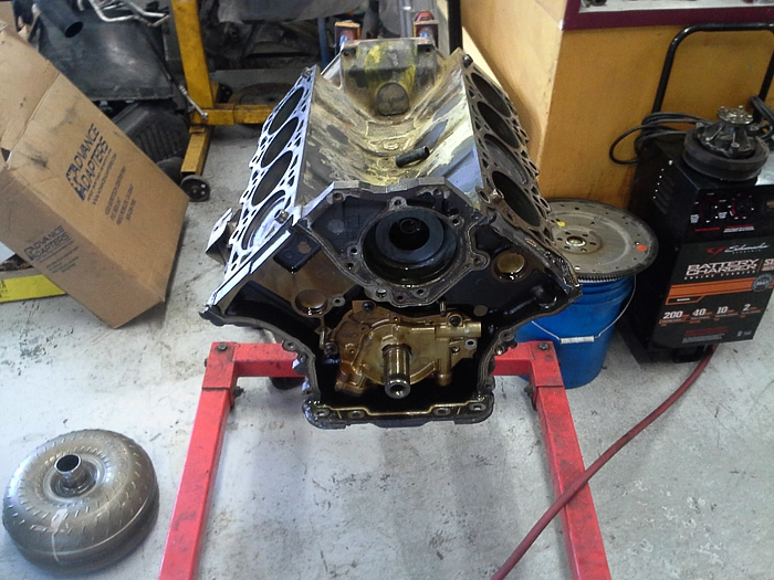

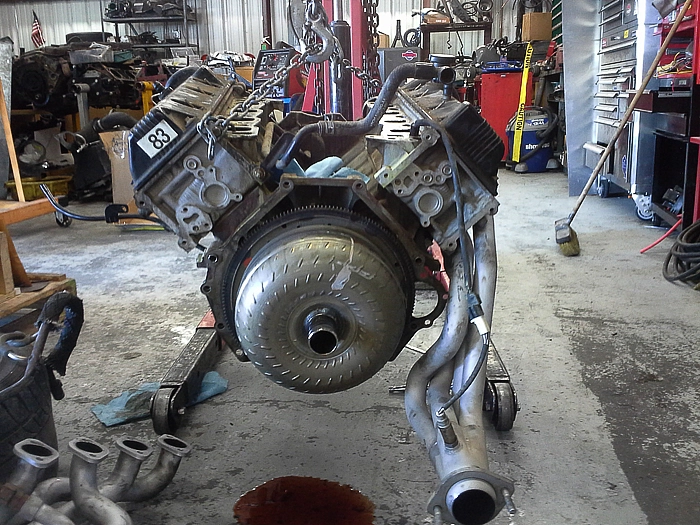

Pulling the motor:
Forgot to drain the tranny....OOPS :chair:
Factory converter

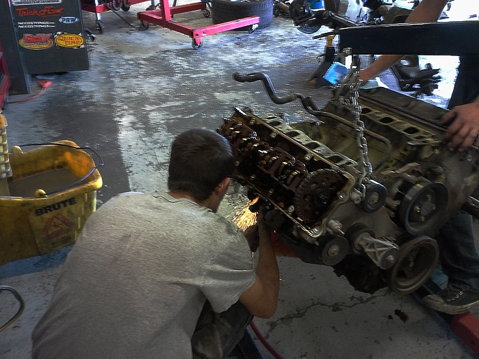

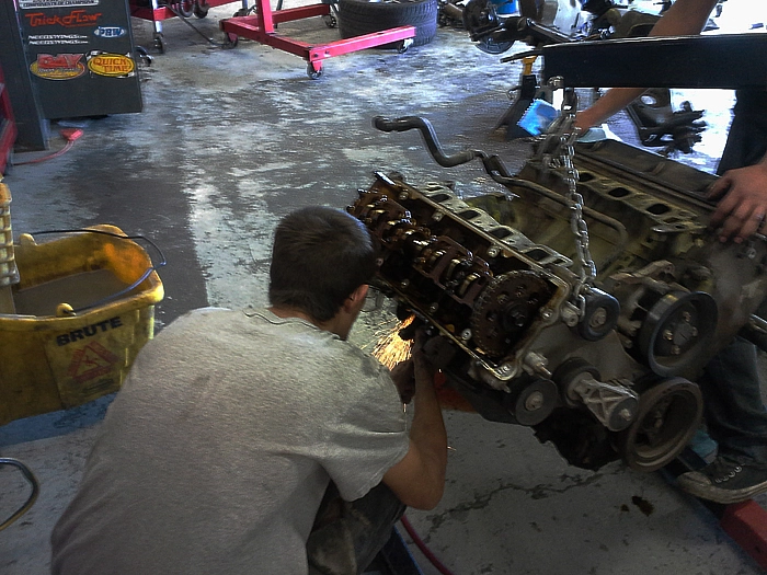

Cutting stripped bolts holding on converter

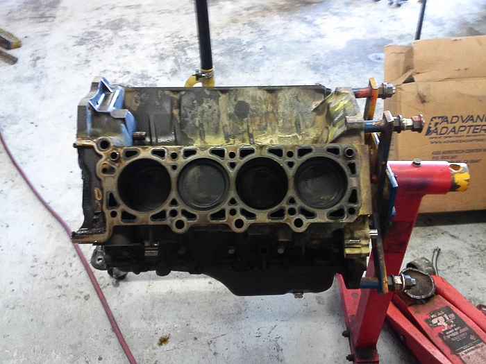

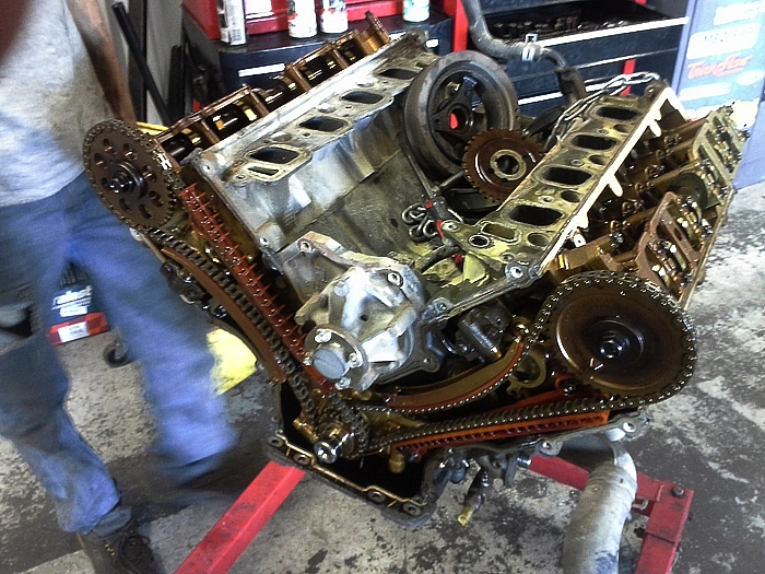

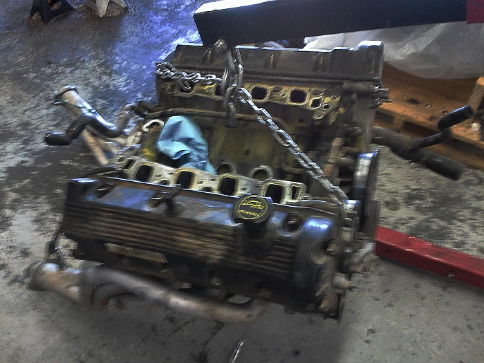

Timing cover off. Everyone was impressed with how cleanmy motor was. Frequent oil changes FTW!
:cry:
