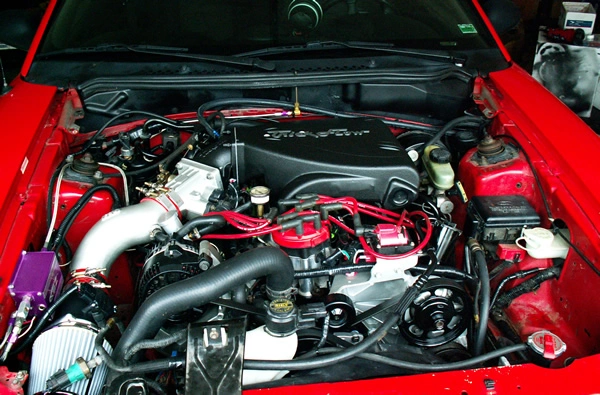

Example:
I have no idea what it does power or flow wise. I just know it was better than my stock rubber setup. Much nice to tap for nitrous. BTW - I bought it used off ebay a LONG time ago. Oh, and as I said in a PM. With my stock engine the temp sensor was fine. But with my new TrickFlow setup I did find it less stress on the harness to extend it a bit.

I've recently installed the Anderson PPipe & MA meter. Pricey, but really woke up my mild H/C/I combo. To install, the wires to the meter need to be lengthened, and some sort of anchoring bracket must be fabricated to stop the pipe/meter from rattling around in the fender.
I installed 24lb injectors & a 190 fuel pump at the same time, but I think the bigger intake made the most difference. I'll dyno it soon, & 25-30 additional HP is my guess.
I also worry about the low hanging air filter (just behind the parking light) and I am going to make an aluminum shield to guard against inhaling water & snow, 'cuz I have a daily driver.
