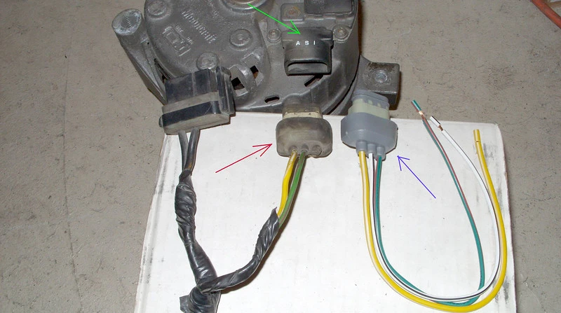

Has no one read anything I've posted?
I have been trying to get to the bottom of this for a while now to put a 3G in my own 1986.
Below I have a pic that will let everyone know what is going on with the '86 wire set up.
RED arrow: The factory wire harness.
BLUE arrow: The pig tail that came with my alternator.
GREEN arrow: The stock alternator that has little letters molded into the plastic
where the wire clips into. (I put "white out" on them so you can see them better)
The factory connector has a yellow wire that goes to the "A" on the alternator
and a green with red stripe wire that goes to the stator "S" on the alternator.
There is NO wire in the stock connector that goes to the "I" on the alternator.
The aftermarket pig tail has THREE wires.
Yellow goes to the "A"
White with black goes to the "S" stator.
Green with red goes to the "I".
I have posed two questions to the place I bought the alternator from.
1) What do I do with the extra wire?
2) Are the inputs on the alternator the same as the inputs on the stock alternator?
Because the fact that there is a green with red wire on BOTH connectors but in different places.
I don't want to hook up the new connector with the wires crossed and ruin the alternator and I need to know if the "I" wire is needed and if it is, what does it get connected to?
I can't seem to find anyone on this planet who can understand what I'm explaining... present company included.

ok, so I went to my buddies house yesterday! I was going to take a few pics of the 3G done on his 86, but there was no point. Its simple, the green/red and the yellow/white just match up and the white/black is the stator wire which just plugs into the new alternator. I cant believe its that simple, but he has had the car for well over a year and not one problem with it charging? Maybe its not the correct way but it works so Im going to give that a shot??

I know I am bumpinng a very old thread, but I went to upgrade the 2g to 3g on the 86 t top I bought last week and was scratching my head looking at the two wire power and regulator plugs... no white stator wire to be found. I had a 3 wire regulator plug I pulled from the junkyard and connected green to green, yellow to yellow, and the white stator wire to the stator connection on the 3g. I tucked back the existing regulator and power wires in case I ever want to return to factory.
Know that mid year 86 Ford switched from external to internal regulators. If your car has the D shaped regulator plug, it is internal and to do the 3G upgrade all you need is this, which you can also get from a junkyard .
https://lmr.com/item/PA-462802A/86-Mustang-50L-2G-To-3G-alternator-Conversion-Wire
If you have posts on your alternator then you need to tap into your external regulator for the stator wire and run the wire stator wire from the external voltage regulator to the stator terminal on the alternator.
