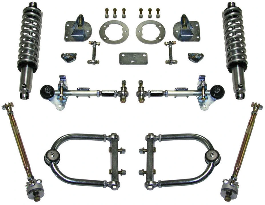

Lookee here, another coil-over conversion kit for the '65-'66, from Ron Morris Performance. Joining TCP, Global West, and Unique Performance in the two-arm market, and RRS and Fatman in the MacPherson. The link: http://www.ronmorrisperformance.com/01hot_new/index.html
$2500 gets you these parts:

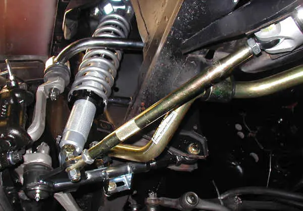

As installed:
The coil-overs are QA1 12-ways. 1.75" Shelby drop. Adjustable tire stops (something I could use with 235/45-17's on 17 x 8's w/5" BS). Two-way adjustable sway bar. Retains OE steering. Adjusts camber by changing LCA length (not good).

For some reason the clevis ends on the strut rod just seem like a bad idea to me... i know the main load is in the shear, but if it's possible to break a strut rod it seems like that'd be a little weak to me

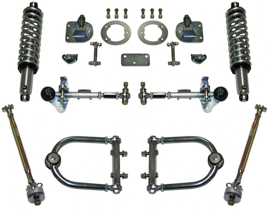

A little comparison shopping:
According to TCP's own website, TCP wants $2200 for this kit, using VariShock coil-overs, 16-way adjustable for compression and rebound (256 possible combos), UCA length used to adjust camber (not good):
I'm guessing the spindles are not included. I'm also guessing, because the TCP kit is so much cheaper than anyone else's (when did you ever think you'd see that?), and because the strut rod is kind of "grayed out" in the jpg photo, that the TCP kit doesn't include the strut rod:
The strut rods go for $370/pair. Adding that to the coil-over kit brings the total to $2570.
Anyway, here's a link: http://www.totalcontrolproducts.com/coil.html
According to NPD's catalog (available for download as a pdf, but I can't link to it), the Global West stuff goes for $2750 with non-adjustable shocks, $2995 with single adjustables, and $3,250 with double adjustables. A $500 swing, depending on shocks? That's a lot. Anyway, here's what you get:

What makes adjustable upper arms bad and solid arms adjusted with shims good? If anything the adjustable arms would make setting or tweaking your alignment pretty easy.
I think the problem with adjustable lowers is that you will encounter adverse steering effects as the length of the arm changes due the geometry of the knuckle being designed to have the steering arm and tie rod end travelling as close to the same arc as the lower arm ball joint as possible. Also the arc the strut rod travels will be altered with an adjustable lower control arm.
I don't see any problem with an adjustable UCA though.
I think the Strut rod is included. In the TCP PDF brochure, under the picture of the coil-over kit, it only denotes the spindle as "not included".
That brings the TCP kit to $2200.
Control arms should be the same length from side to side. If you can achieve that AND correct camber on both sides too, then using control arm length to adjust camber would be OK. However, that's pretty unlikely. On the other hand, since you could leave the control arms equal length side to side and use shims to adjust camber with the TCP, UPP, or RMP kits, it's really a non-issue. Or you could add an $80 Pro Motorsports "Vario-Centric" LCA mounting kit to your '65-'66 and skip the UCA shims too.

Just to confirm, the $2200 price does include the strut rod. (data sheet 437K)
And you are free to use whichever early Ford spindle and brake combination you wish.
In my years with TCP I have never seen an upper shock mount failure other than some sheet metal distortion at the mounting bolts (mdjay), which all manufacturers have address by adding the support ring or placing their mounts underneath the tower. As far as the mount design itself, it has proven to be an extremely reliable, low cost design. We could make a pretty billet aluminum one but then we would have to sell a $2500 kit instead of a $2200 kit for a part you don't see once its on the car.
The adjustable upper control arm is to provide an increased caster range beyond non-adjustable arms, without having to draw the lower arm forward creating clearance issues with the fender. We supply shims to place between the pivot shaft and shock tower to avoid having different length control arms. I don't have an image on the webserver but the shims are shown in the upper control arm data sheet (394K).
