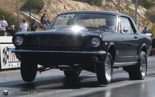

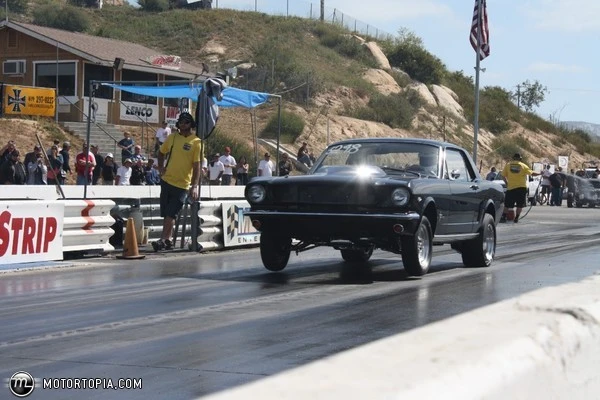

here are some action shots of the front suspension and complete setup hooking.
it ran a 1.77 60 foot time with a 300hp motor. So the race motor should run a little better.

nice! it pulled the wheels with a 1.7 60ft?

  • #29
on the back tires

Is that you or your dad driving it? Whats the race motor?
Yep, it launched around 5000rpm but ran out of motor. It was the first time at the track with this setup and slicks. So more tuning is in order. Need some more sorting of the top loader four speed then the race motor will go in.

mrmustangman357 said:
on the back tires
HAHA, I doubt that!!
That was my dad. Did you see the motor on the engine stand that day you stopped by?
its a 319ci SBF with some other work done to it. We are going to do some head work and re-assemble it. It should be ready to put in this summer. Should be worth a few more horsepower.

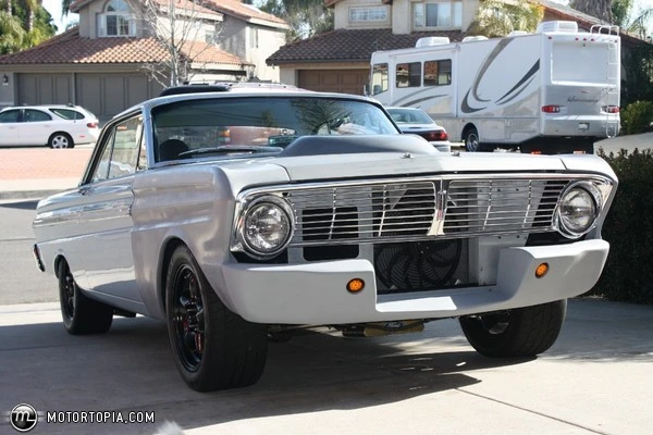

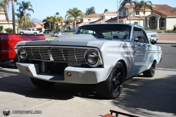

Shogun,
yep, my falcon now has a shelby valance on it. It looks great. I will post pics later.

Here you go......

looks pretty sweet
