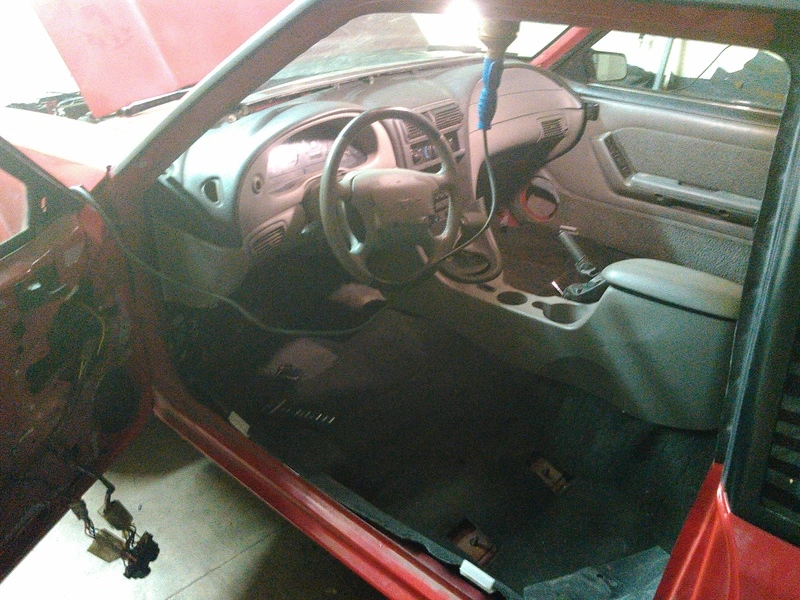

Did a modfox swap and got it started before I got the interior in. Got the interior in and now I'm having crank no start. Can smell gas out the tailpipes after cranking. Have voltage at injector and cops with key on. Should the tach be moving during cranking? Pats proves out. Fuel pump primes and gives pressure. Anything I might have missed? If I'm getting gas smell out the tailpipes, is my crank pos sensor working? Fuses all good. Any ideas?
