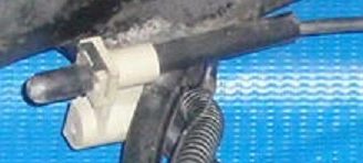

I also swiped a picture off of ebay and trimmed just what I needed. I have the light gray part, but I do not have the little flat black clip that goes into it to hold the cable end in place. As our salvage yard situation is sad, I hope I can find it at Ford or jury rig a new clip.

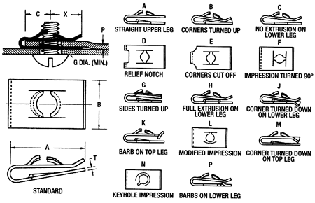

What you are seeing is 1/2 of a tinnerman clip nut used to secure sheet metal or machine screws in very thin sheet metal. Use a small abrasive cut off wheel in a Dremel tool or air powered cut-off tool to cut it in half and you have what you need.
Here's a picture of what a tinnerman clip nut looks like in it's orginal whole contruction so that you can get the idea.
Thanks for the easy hardware store solution for next time. If Ford did not have it, I was planning on using ti and some micro files to make it.
Ford said "NO PROBLEM!" with the picture I linked to. It was a nice surprise. I will have one Tuesday or Weds for less than $3.00 with tax. So this time it was not worth a trip to the salvage yard or to hardware store. But next time, I may be very glad to have the info.
