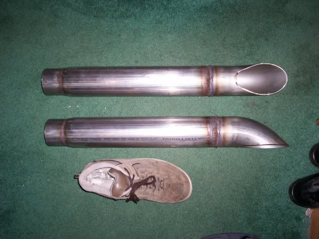

Ok, i know, i do change my exhaust a lot, about a few times each month, but i can build any muffler i want for free on my own time and im just researching and designing stuff here.
These are based off of what are called rat trap mufflers from Stainless Works, the company i work for, They are basically the same except for the turnouts on mine are slightly different.
I made these due to their high flow, they seem like they would be just a tad quieter than dynomax race bullets right off the headers and give “some” scavenging.

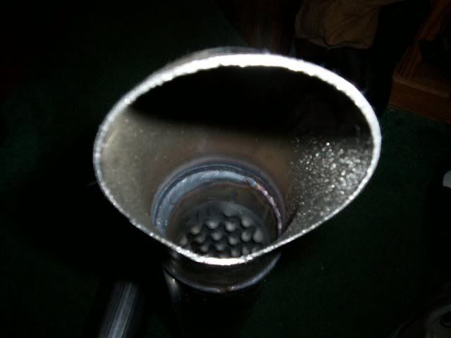

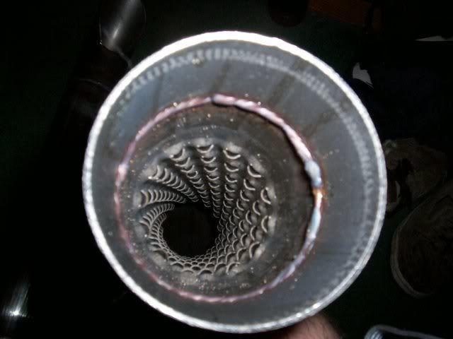

They are all 304 SS, 16.5” core (12” of perf) at 3” diameter, a 3.5” body about 19” long with 3.5” turnouts welded on. They will be a space saver too. and stainless wrap around the core for sound deadening. Compared to the race bullets aluminized steel body and core with fiberglass/ceramic packing.

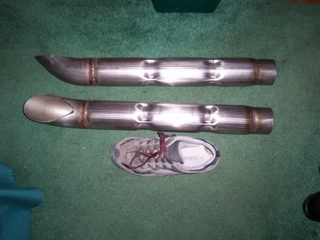

REVISED DESIGN TO QUIET DOWN A BIT, 2.5” diameter core, a little longer and added chambers for that raspy/throaty sound:
OLD DESIGN, too loud:

Thats what they’re supposted to be used for, but i just put em on my car right after the cutouts which is about 2 feet back from the collectors, and wow they’re loud, they have a really nasty tone to them above 2,000 rpms though which is awesome :) I think I’ll leave em on for a little bit. On a catted system they would work great.

I will contemplate that, i’ll see if i can make another pair soon with 2.5” ID inlets. Lemme see if these are too loud though before i make more, the other ones were just short of open headers.
A guy I work with sid that 2 1/2" inlets and 2 1/2" turn-downs should take the sound level down..:shrug: ..You've got my attention on these!!!:nice:

I got my stainless works 30" chambered mufflers in the mail (accidentally got 2.5 I.D instead of O.D, but plan on making them work). Just wondering which way I should install them? Is there a noticable sound difference whether the exhaust gets "trapped" in the louvers or turned around where it flows "over" the louvers? I plan on having it being trapped to keep some noise down if that will be possible. If not, o well, we'll see how they sound.
If you turn the louvers the wrong way, facing back, it will most likely do almost nothing to deaden the sound and give it that flappy glasspack sound, keep the louvers facing forward and it will give a very deep rumble very throaty, quiet when crusing, loud when you get on it with almost no interior resonance. I have a shortened version on my 99 ram and i love the way it sounds.
