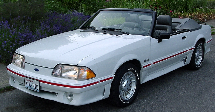

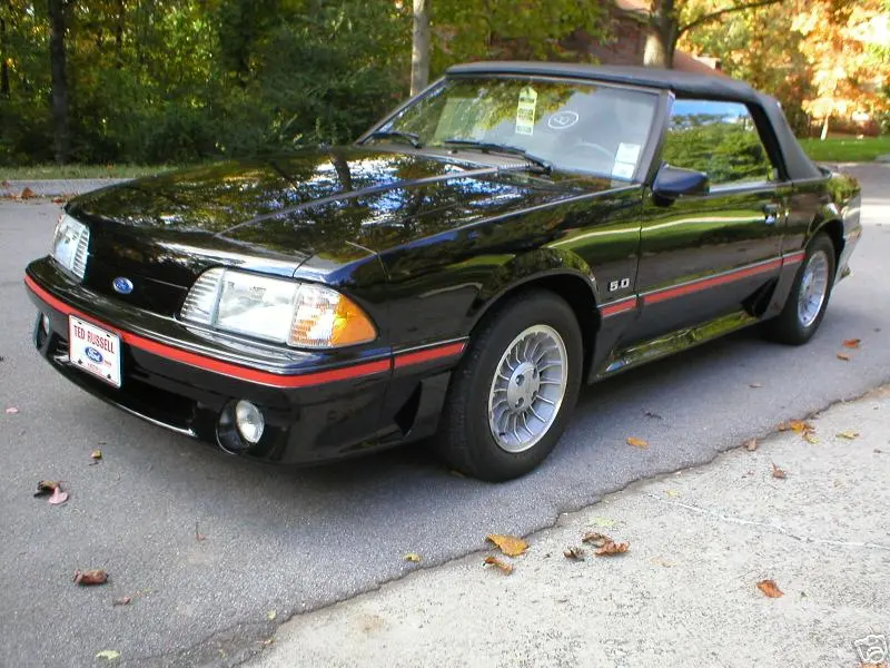

Question is though, there are two different convertible doors. One has the mirror like the hatch cars and the other is the pedestal style on later 88+ convertibles.

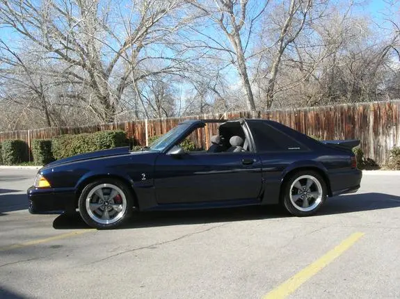

Only the 1988 t-top cars came with the later pedestal mirrors, so unsure if oyu would need to find some 81-87 convertible doors

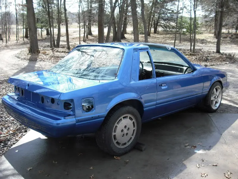

i have an 87 t-top shell and it came with the corner style mirrors i am swapping mine over like the blue car .i picked up some convertible doors with the pedestal sail mirrors as well.i have 2 sets of t-top door glass and they both came off an 88 t-top cars with the pedestal sail mirrors.i don't know if the 87 t-top glass is different from the 88 t-top glass.something to think about

Anyway, we still haven't determined if the t-top glass is the same between the normal style and pedestal side glass. Needless to say 81-early 88 t-tops cars have the same doors as 81-87 convertibles, while late 88 t-tops cars have the 88+ convertible doors, but with different glass. The million dollar question is whether the 88+ convertible doors will accept the 81-87 t-top glass and seal correctly up front where the mirror no longer is on the pedestal doors. That kinda makes me think no.
