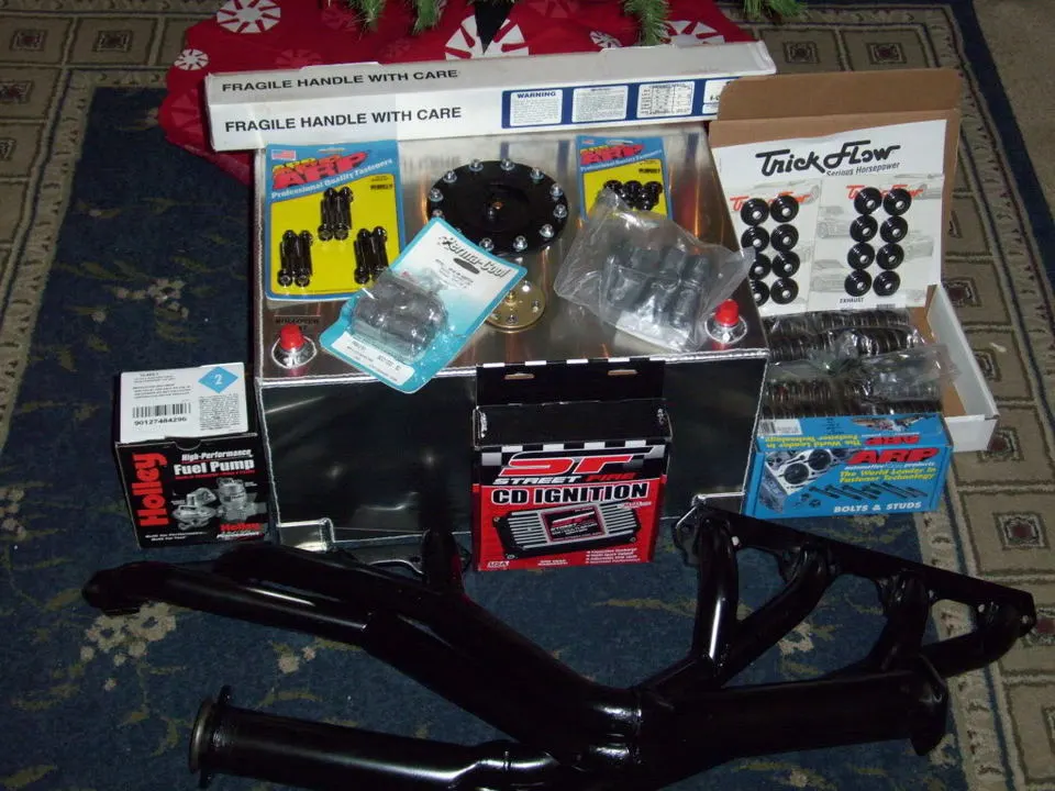

my goal with the truck is to break into the 11's and still have AC and decent street manners
I hate to burst your bubble here, but 11's in a lowered 2WD ranger, with what's basically a warmed over 302 is never going to happen. Even with a 150 shot you're still going to come up waaaaay short. Running low-13's/ high-12's might be more realistic and even then it’s going to be a stretch!
