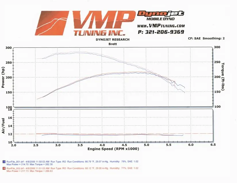

I was wondering if you guys could give me an idea of the rear wheel hp im putting down.
95 gt 5speed
9mm plug wires
msd blaster coil
underdrive pullys
smog delete
shorty headers
o/r x pipe
40 series flows
c/a/i
edelbrock performer upper and lower port mached
king cobra clutch
timing at 17
this is my dyno 217.73 hp and 286.63 tq. and he is running a similar setup as mine minus the edelbrock performer upper and lower port mached....and this is minus the nitrous...
