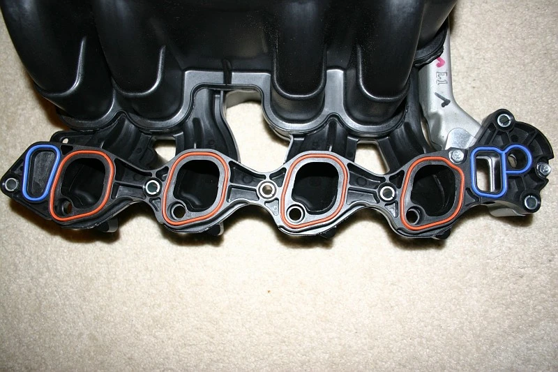

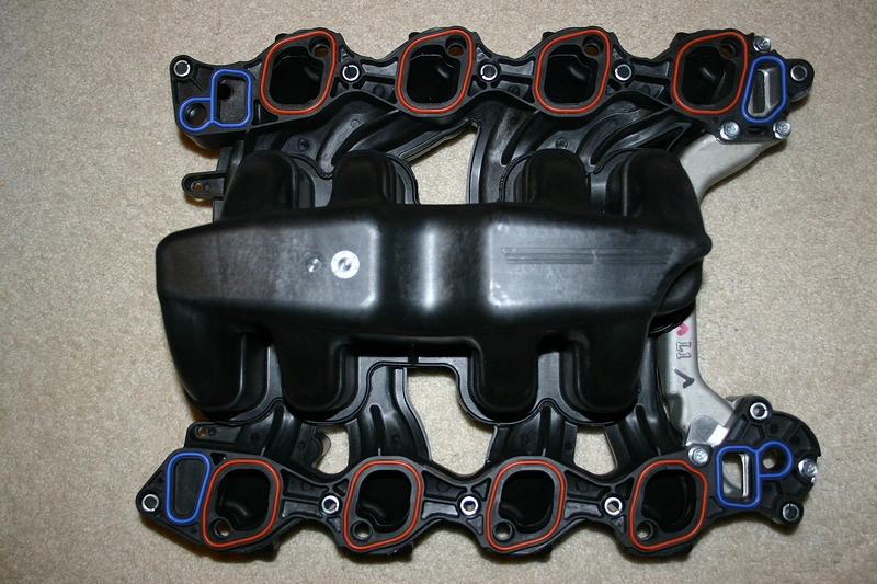

#1 - The only part number I can find on it is 615-175. This doesn't seem to be a Ford part number but maybe it is. I'm hoping it's not some knock-off or something but it has me wondering mainly because of the following.
#2 - The aluminum crossover has 2 ports for the sensors but the "kit" includes a plug if you don't need the second port. I thought I would have to tap a second hole, not that I'm complaining I won't but I didn't see any reference to a PI Intake having the second port already drilled.
and
#3 - The paperwork it came with claims that it does not require additional intake gaskets. It has "molded" gaskets in the bottom, they look like o-rings. Again, I haven't read of this before and I'm wondering how it will work with the RTV method of using NPI gaskets vs PI gaskets and the whole sealing the air vs coolant debate.

Take some pics of that. I would like to see the ports on it:nice:

Here's a few pics.

That's a Dorman PI intake IIRC...they came with the 2nd hole pre-tapped and with built in gaskets. I know I've seen manifolds like that before. Don't worry dude, you just got a manifold that will make your headache a little less painful when doing the swap. Just use a TINY amount of RTV to seal up the coolant ports and you'll be fine.

Here it is, your 615-175
https://www.dormanproducts.com/cgi-...&vfrom=&prev=&vnext=&category_list=1442:676:0

It is a Ford PI Intake...modified by Dorman.
