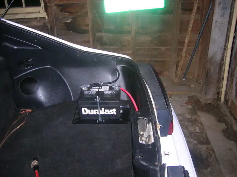

ok, ive searched this a few times but I gotta get this straight. I have 20 ft of 0/1 gauge wire-- I use this wire as a ground from the battery to the quad shock and also to run my + power wire from the battery to the solenoid. Do I also need a 2gauge wire to run from the negative terminal to my chassis ground up front near where there battery use to be? Am I suppose to run a 4 gauge off of that to the block?
dude mine is grounded to the body in the trunk, i dont think it matters as long as your engine grounds up front are good. ive never had problems with mine.
I used #1 for the power that goes up front to the solenoid. Also used a #1 for the ground that I ran all the way up front to the sway bar mount, from there I grounded the block also with #1. At first I had starting problems, but that turned out to be a weak battery. With my new battery it fires up everytime without any problems. By the way, its the taylor kit but I got some cable from a friends father that he got from work. Use can also use welding cable.
I used 1 gauge and ran everything back to factory locations. I'm also going to be changing the ground strap from the block to frame with heavier cable. I don't know if it will make a difference, but at least it will be a better ground. I also used an Optima battery. I didn't like the fact of having a hatch with a regular wet type battery.

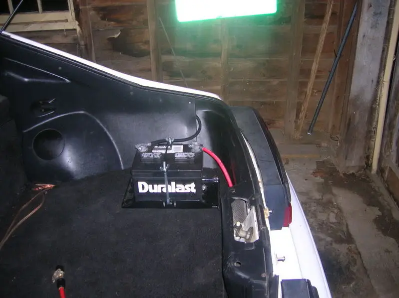

Rear mounted battery ground wiring. Follow this plan and you will have zero
ground problems.
One 1 gauge or 1/0 gauge wire from battery negative post to a clean shiny spot
on the chassis near the battery. Use a 5/16” bolt and bolt it down to make the
rear ground. Use a 1 gauge or 1/0 gauge wire from the rear ground bolt to a clean
shiny spot on the block.
One 4 gauge wire from the block where you connected the battery ground wire to
the chassis ground where the battery was mounted up front. Use a 5/16” bolt
and bolt down the 4 gauge engine to chassis ground, make sure that it the metal
around the bolt is clean & shiny. This is the alternator power ground.
