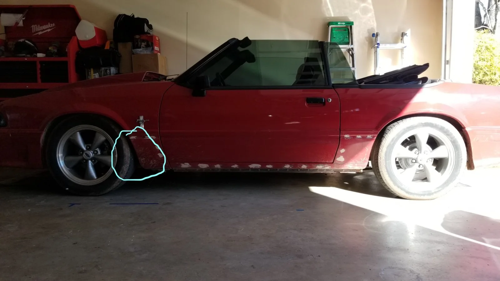

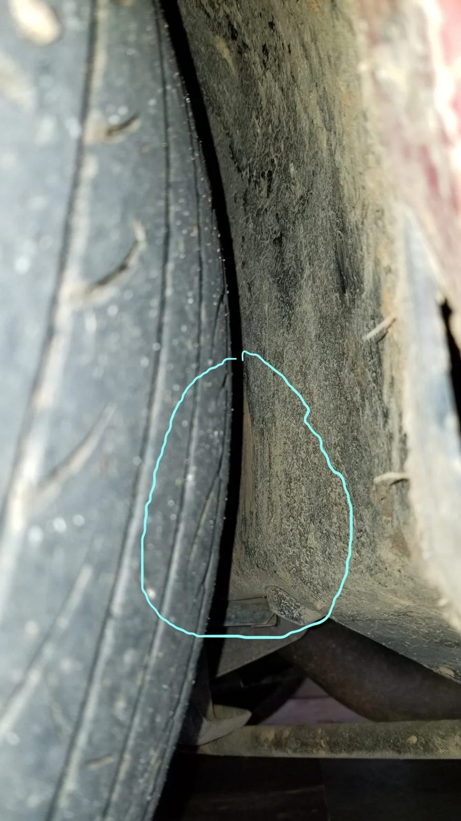

My recently acquired 88 front wheels are rubbing on the inner wheel well down low towards the firewall when I turn at less than full lock. It has a 5 lug conversion (not sure of the brand). Spacers are installed - 1/2" perhaps? It rubs in the same place on both sides.
I'm thinking a little wider spacer may work, but concerned that may cause clearance issues with the top-outside of the fender. Anyone rubbing with this combo?
Pics for reference

I shorter tire would stop the rubbing in the fender skirt but might present a problem with overall ground clearance getting too low. The front of that car looks pretty low already. I bet its scuffed up in the front under carraige already. Any lower and that would get worse. Id maybe try a slightly narrower tire, but im not sure if i would go too much shorter.
Thats a tall tire up there and its stuffed up there pretty good. Any idea how much the front suspension is dropped? How harsh is the ride up there? Pretty stiff i bet
Thanks John. From the little I've driven the car, the ride isn't too bad for a lowered car, but I haven't encountered any really rough pavement. I can get a shot of the springs and hopefully figure out what they are. I like the way it sits now, but if I have to go to a little shorter tire, that will give it a slight rake, which I always thought looked good, too. Not sure what it does to the handling.
I was thinking a narrower tire (225/55) might give me just enough clearance - I don't think it's rubbing that badly, but can definitely hear it when I have to make a right or left turn.

Not for '88. Factory tire was 225/60-15
Factory diameter will rub on '87-'89. Ford changed the skits geometry on later years.

Thanks - seems like if I went with a 225 on the front, that might give me enough clearance, since the tire is about 1/2 narrower. Adding and add'l 1/2 inch spacer should keep the wheel at the same with more space.
Seems reasonable :)
