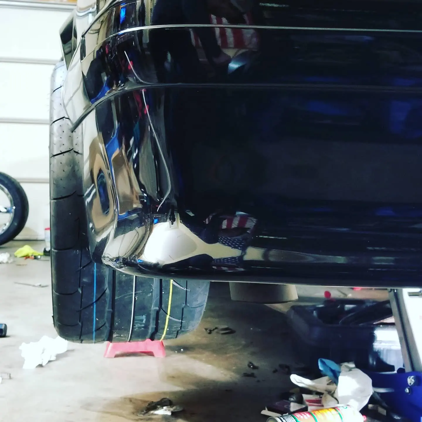

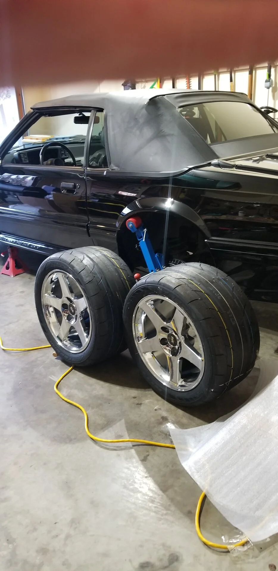

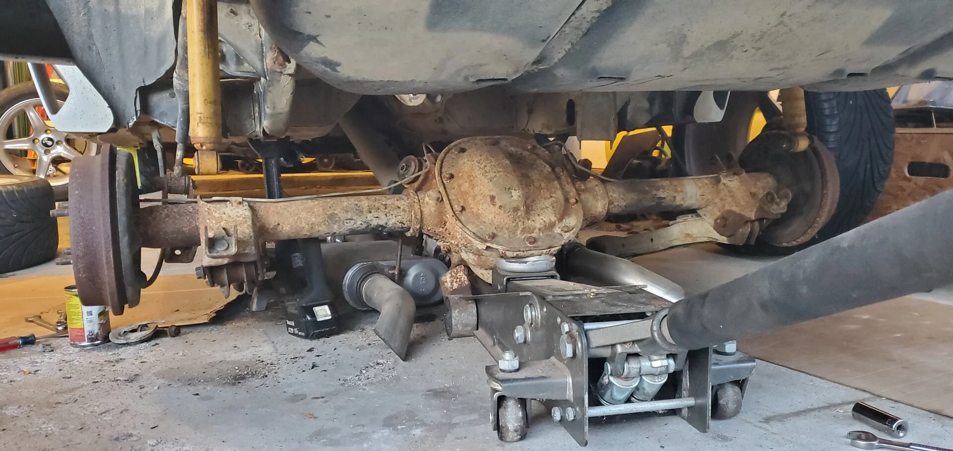

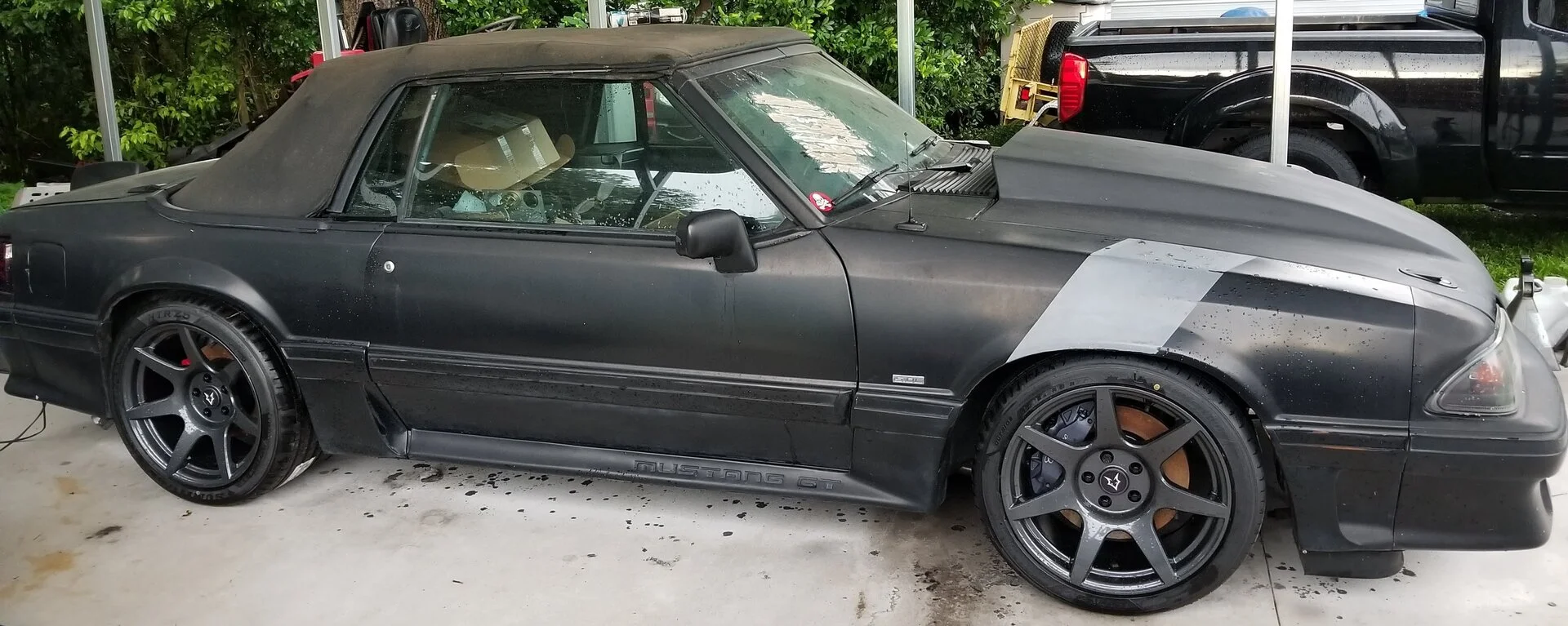

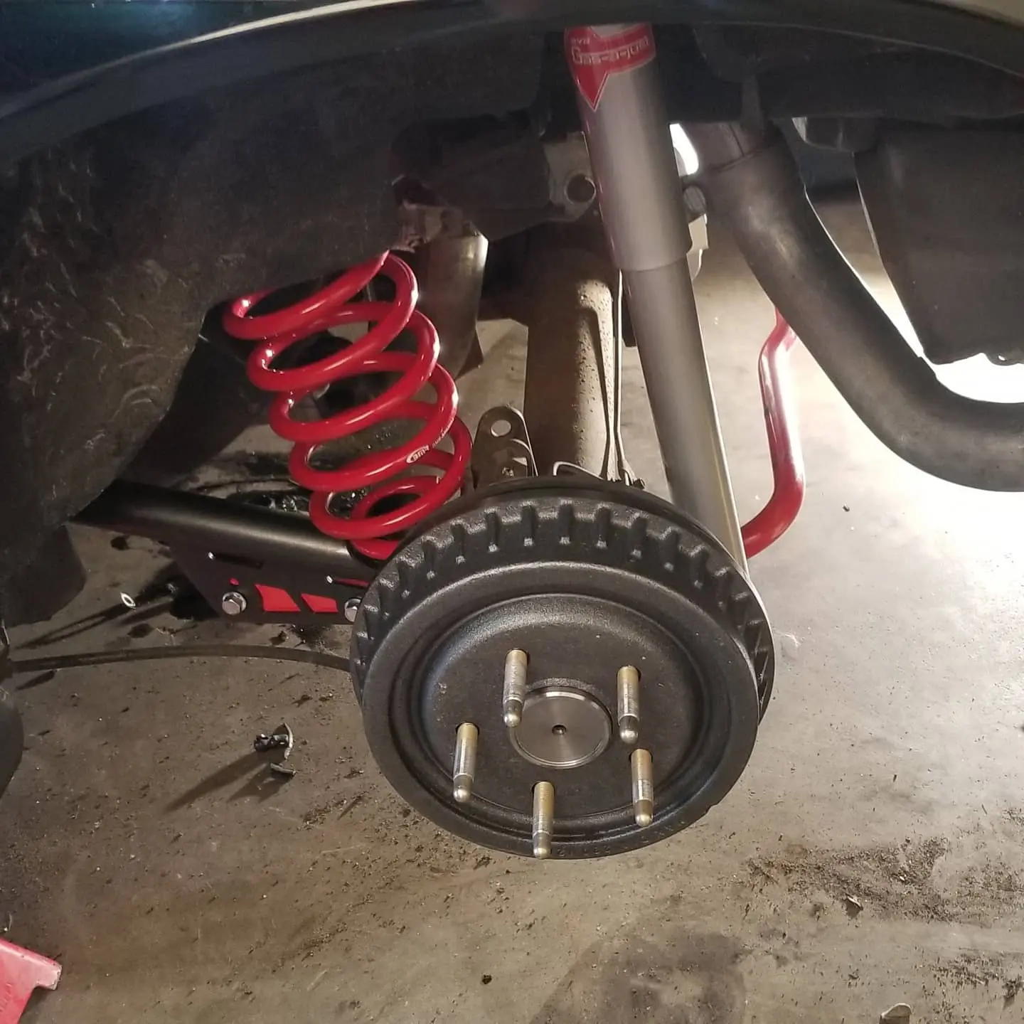

New to the Forum, Not new to foxbody things. Looking for Tire size help. I am building my second 1989 Convertible fox and running a 10.5 Cobra rep from LMR. Current Tires mounted are 315/35/17 Nitto 555R2s. I was unnaware that the R2 have a MUCH wider (dare i say accurate?) tread width. I am used to the 555Rs that ran narrow. My last car that was a twin to this one, wore 17x9 cobra R wheels with 275/40 Nitto 555R rears with no modification to fender well or rolling of the fenders. I know they ran narrow so this seems to be why i thought i could get away with the 315/35 in the R2.... boy was i a little wrong. I have beat the ever living S*** out of the inner fender, fully rolled the lip and I am sticking out just a hair past the outer lip... I want them to tuck in just ever so slightly.... My rear suspension is BMR Lcas, BMR lowering springs, no isolators, stock length 5 lug conversion axles from LMR, and i have the options to run spacers if i need to, but the pics i will provide will show the fitment with no spacer... still rubbing the inner a bit and sticking out.... My question is: can anyone provide a picture of a wider 275/40/17 or something availible that i can run on this 10.5 that is less than this giant 12.68 wide nitto....? I have searched for the dead 555R with no luck...
My thoughts: (i have searched many forums including this one, i know this has been asked before but not in this specific situation)
-Maybe a true 275 MT would be flush on a 275? I know ppl used to say they stretch but seems like they may be ok in some brands?
-I think a 305/45 would look stupid and i am not really into truck sidewalls
-If someone made a 295/40 I feel like that is the ticket... but now i think i should have got 18s rather than 17s....
PLEASE show some 10.5 pics to help a new guy out. I have attached 3 pics of my car. I know that if i had 10.5s 1/4 inch spacer and those old narrow 315 555Rs i would be ok... the tread width is a little less than 12.0 ... these R2s are just to darn big...
Thanks

So I should restate. I have 10.5 cobra wheels and the 315 555R2s are to wide. I know brands run different and I am very close to fitting. I should have maybe asked if a NT05R in a 275/40 may fit on this 10.5. I the contact patch is 10.8 and the tire is 11.1" wide at the widest in a 275. Think that would look square on a 10.5? Also, the wheel fits in there fine the tires bulge a good 3/4 inch off that wheel. The hammering is in process and the lips are rolled flat.

Head cam intake care with an sc trim. I have 13 inch cobra brakes up front. Ill take a risk with some drums for a bit.
Moser 31 spline fox axles. The rims are these

I do not have a picture of the tire from the rear of the car but they tuck up nicely.

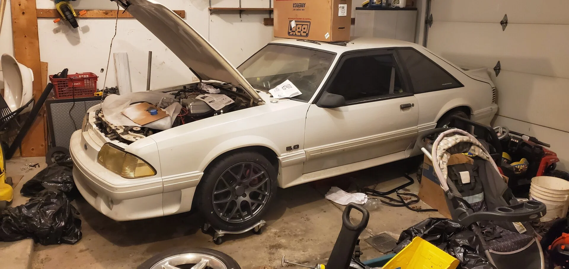

I’m in the process of my 5 lug swap, just switched to the rear yesterday - I have a 95 rear that is going in so I’m likely going to use an S197 10” for the rear... just trying to gather as much info as possible. I’ve actually seen the exact wheels I’ll be running on a few Fox’s in the 10” S197 offset/BS in the rear. The 9” wheel is only +30mm and will stick way out on my sn95 axles (IMO won’t look good)
