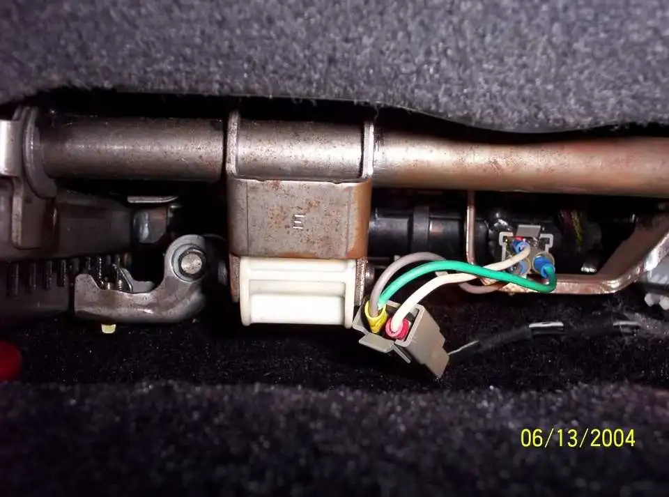

I put front seats from a 03 Cobra in my 93 lx. They bolted right up. I removed the seat belts and the lap belt guide from the new seats. The new seats should be 6 way powered, so you can adjust the height of the seat. There's a thread where I got the wiring change here. It worked out fine. Good luck.
Here's the picture of the wiring that I used.

Your stock wiring is one power and one ground, use a test light (its hot ignition off). I'm not sure about 01 GT seats but they should have
-one ground (black)
-one wire that is smaller than the others for the seat belt warning
-either one or two large power wires (same size as ground, just not black) for the power seat. They are likely just onepower wire since they don't have lumbar/bolster adjustments.
Just did this also with 03 Cobra seats, once you see the 01 seat wiring it should be obvious.
