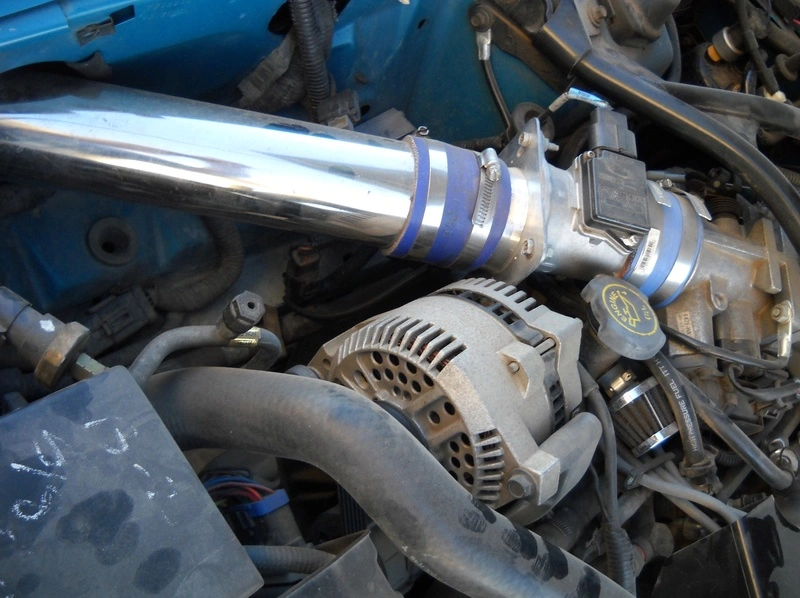

I expect you won't agree, but as a quickee, I'd move the MAF sensor to the other end of the shiny pipe. imp

If the maf is placed too close to a bend it changes the airflow, too close to the bend at the tb, like the 90 degree turn in the pic, the airflow will slow down and not give an accurate read.
Place the maf too close after a bend and the turbulence right after the bend can cause erratic readings, sometimes that can be helped by 'clocking' the maf, if you look at a stock maf there is a screen that acts as a 'air straightener',
To get a picture in your head, take a piece of 3 or 4"pvc a foot or so long and use a 90° first then a 45° and then a 45° sweep at the end, I took a siphon gun with about 6psi siphoning from a water can and watched how the mist exited the turn, I noticed the higher the pressure the worse the 90 backed up.

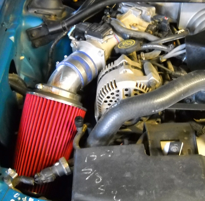

@karthief I gotta admit, you guys are on your toes! I failed to see that elbow in my dark image, but should have realized it was there. OTOH, the MAF could be placed halfway along that long straight-away. In reality, I suspect real laminar flow of air in hardly any of these duct systems is hard to find.
Note the problems started some years ago, getting progressively worse. Hard to blame suddenly appearing turbulence happening, I think. Here's an interesting imponderable. What it had:
What it has now:
Runs smooth as a baby's ass! Idles perfectly, runs well hot, cold, in-between. Why? I dunno. imp
What it has now:
