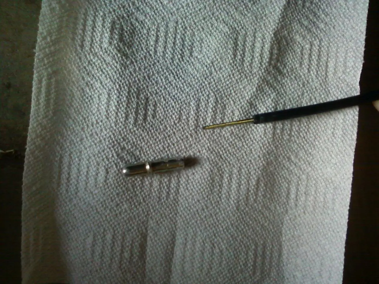

Well, I figured it out.
Got the car home Friday night and sprayed the underside really well with the hose to clean off any old trans fluid. That way, I could see where the fresh fluid was coming from in the morning.
It was definitely the speedo cable leaking. The fluid was running out of the crimped ferrule and dripping off the cable. The ferrule was completely clean and dry, so the fluid definitely wasn't running out of the VSS.
Just out of curiosity, I tried pulling on the ferrule and it came off ridiculously easily. The crimp was for junk. There weren't even any decent indents on the cable made by the crimp. It makes perfect sense that it would leak.
Not trying to knock D&D here; the trans itself has been wonderful and their customer service is always great. It just seems like their cables are pretty poor quality. I don't know where they get them from, but after having two leak like this I would stay away from them.
