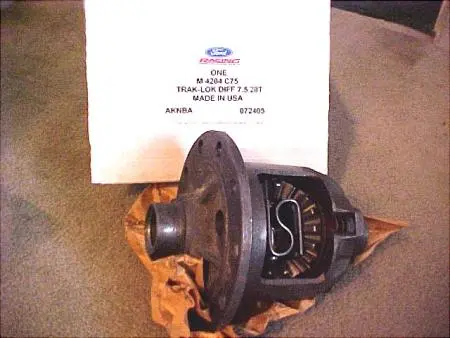

shooterm1 said:
Got it! > MVC-029F.webp <
