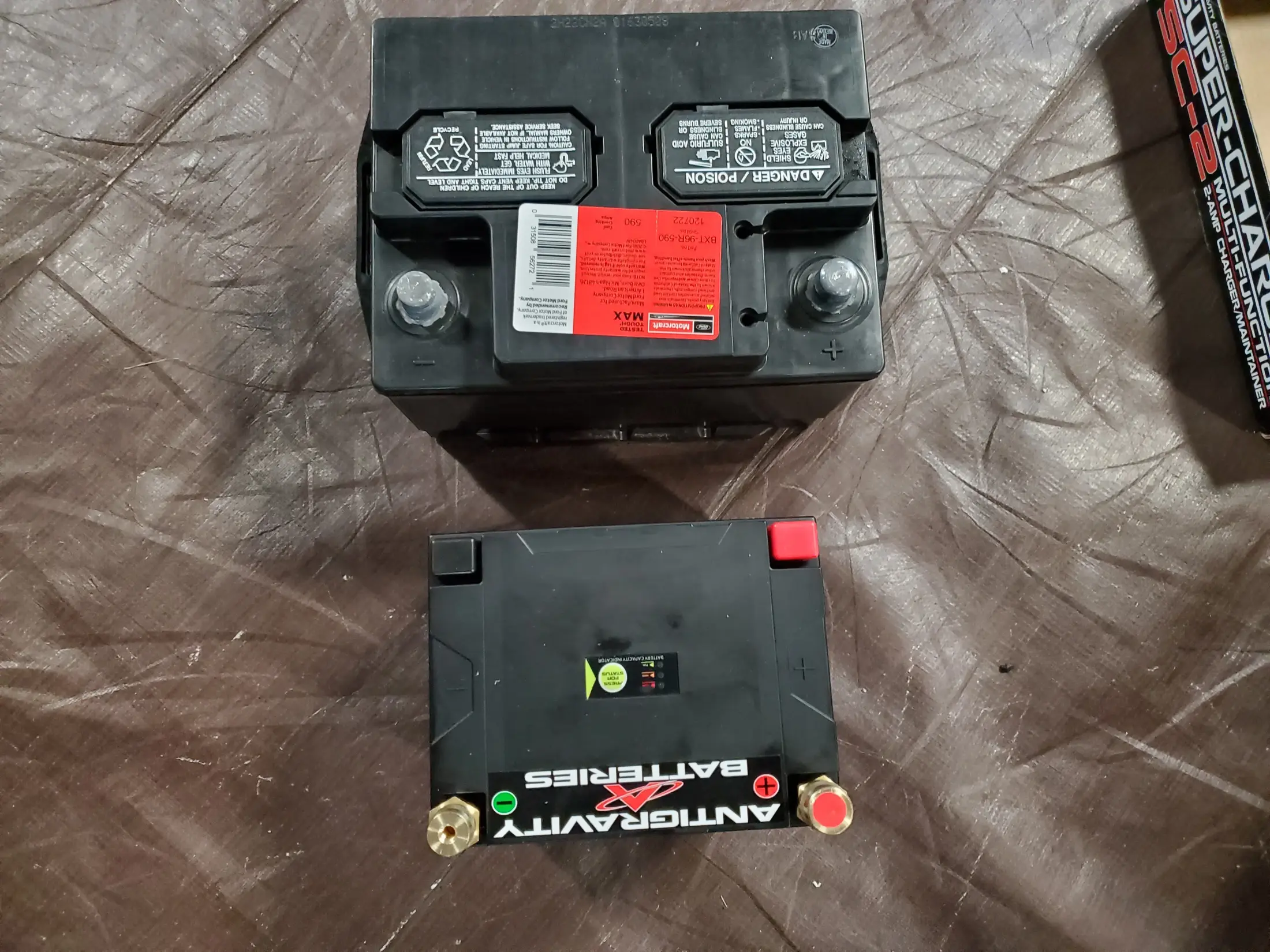

and I thought mine was some $$. I'm using ATX30HD.
So far no issues, but have not run a full track day to see
if it's happy with "modern" charging strategies.
Mine was a decent weight savings, trying to get some
of that weight "back", after the roll bar install.

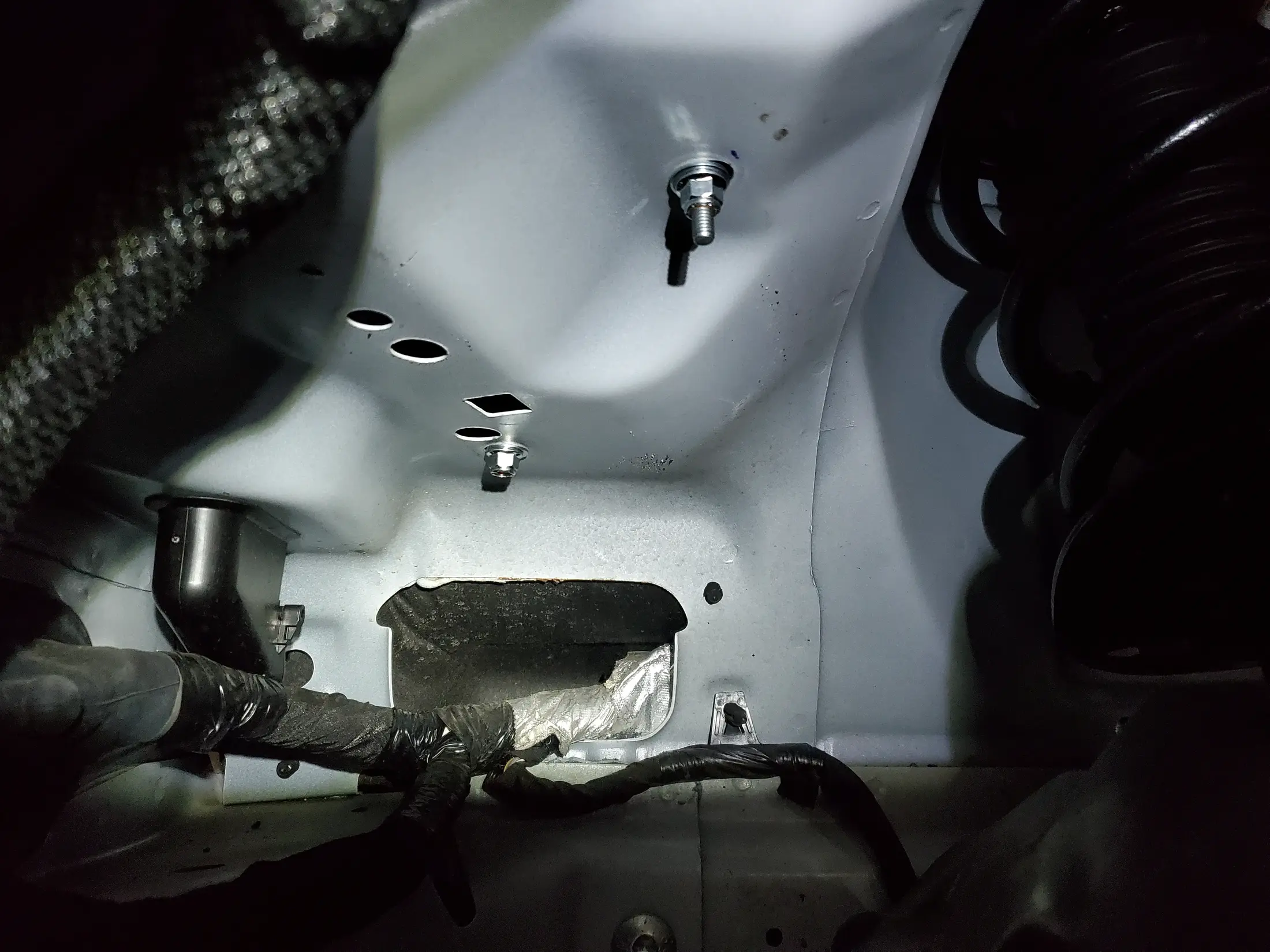

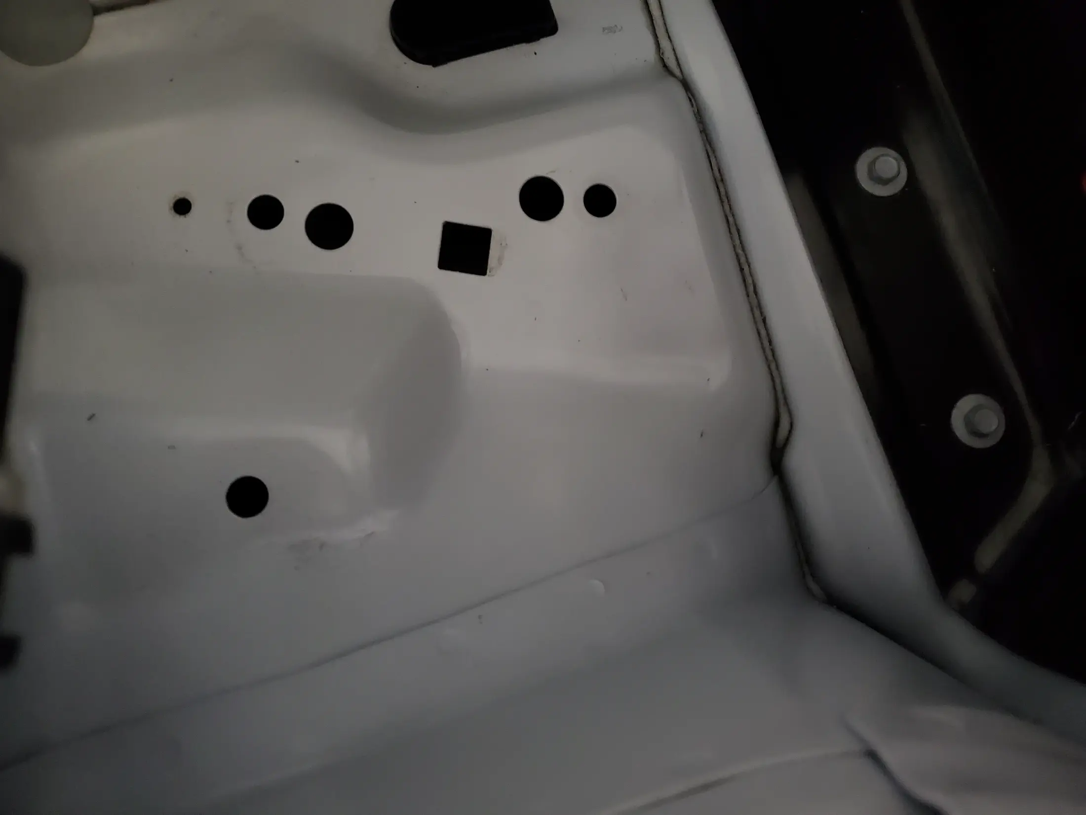

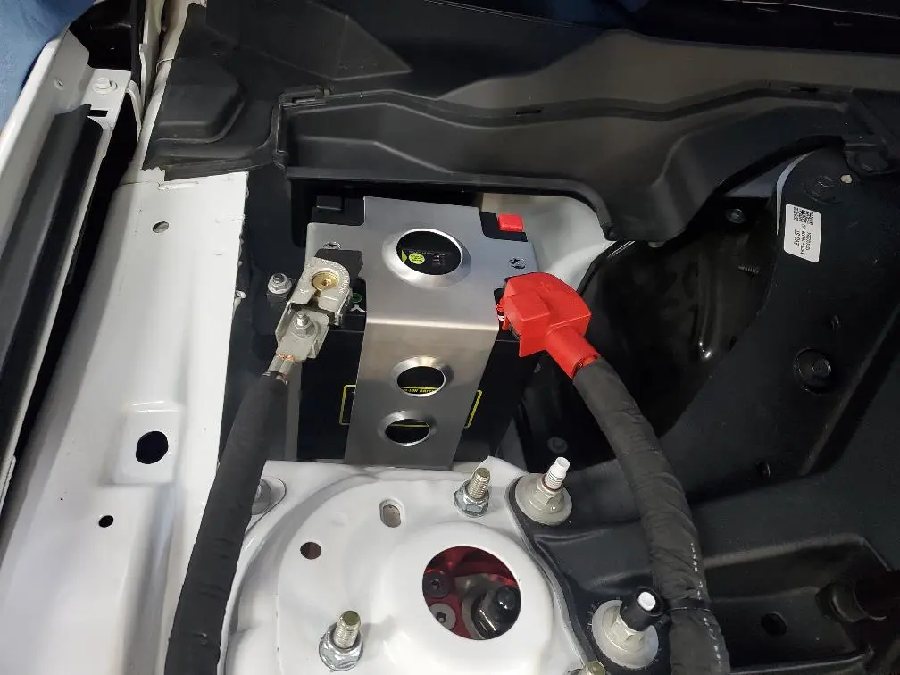

Had to make a new mount to mount, for that bracket over the top. Basically just a thin flat plate bolted directly
to one of the front mount bolts in the "inner fender". That area recesses as you go towards firewall, so it had to be
spaced up with a small block ( I used the wedge that normally holds stock battery in) on the other more rearward
mounting bolt. Most people could fab it easy with a drill press
It's a minimalist bracket, but that battery literally feels like you picked up an empty plastic box, so I figure
it's momentum, even in a crash would be minimal. Not sure on all S550's, but GT500 has a metal "firewall" of
sorts between battery area and the engine compartment. So I wasn't as worried about thermal, although stock

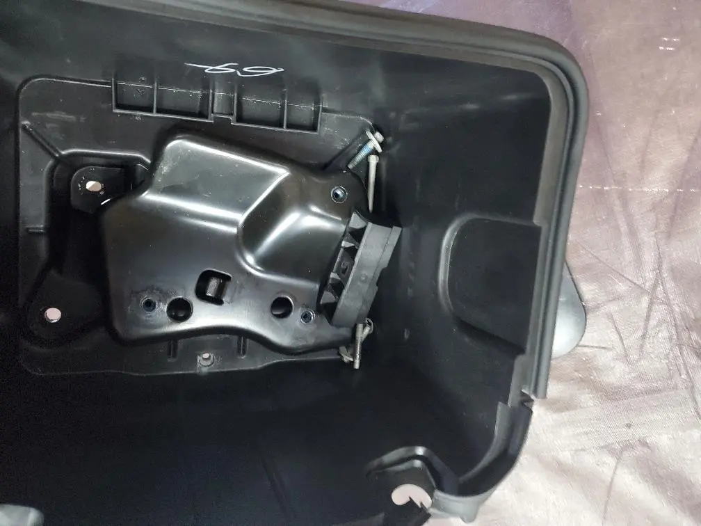

battery is in it's own plastic box (which had a pretty heavy steel mount bracket under it, and that was part of
weight savings).
This is the pile of stuff I'm not using (except that small plastic wedge on right).
