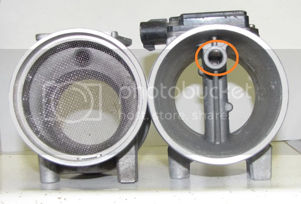

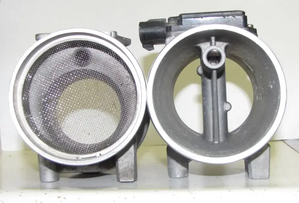

This is a 95 Thunderbird MAF. The electronics on this are useless to us Mustang/302 folk, but the housing is virtually identical to the 1993 Cobra MAF. It's a 70MM unit, has the correct inlet/outlet configuration and even the 3-post mounting (that usually isn't used). I am aware of one person who took this housing, and installed a 94-95 Mustang MAF electronics on top and ended up using it.
Here is a 94-95 Mustang. The internal features are the same as the above t-bird MAF and the cobra MAF, but you can see it uses a different mounting flange. The electronics however do match up and function with the A9x ECU however. I am using this exact MAF, with an adapter flange. However if i had found a check tbird housing (above) i would have made the swap.

Actually looking for dims on the flow tube (circled above).
I did some quick math and the 70mm pictured above might only be marginally bigger than the stocker. The tube width and ID can help me finish off those calcs.
thingies aren't long enough to measure ID perfectly, gauge not exactly perpendicular, but I get ID 9.75 OD 11mm
