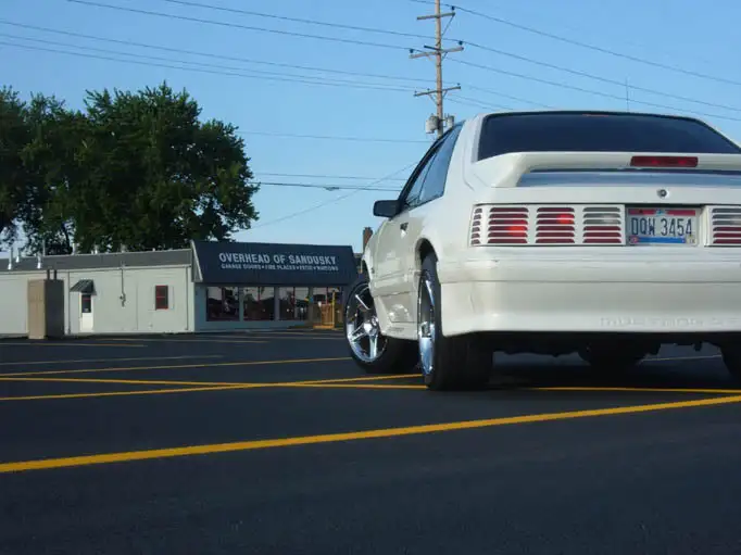

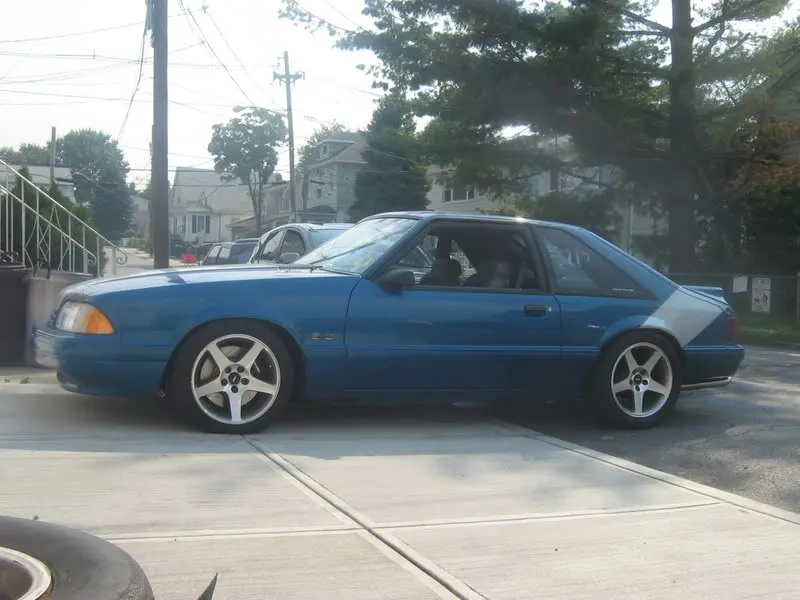

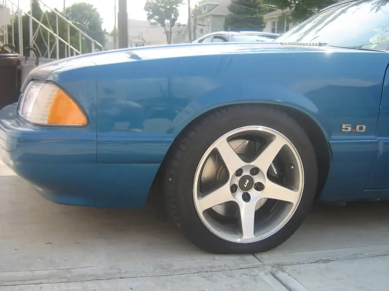

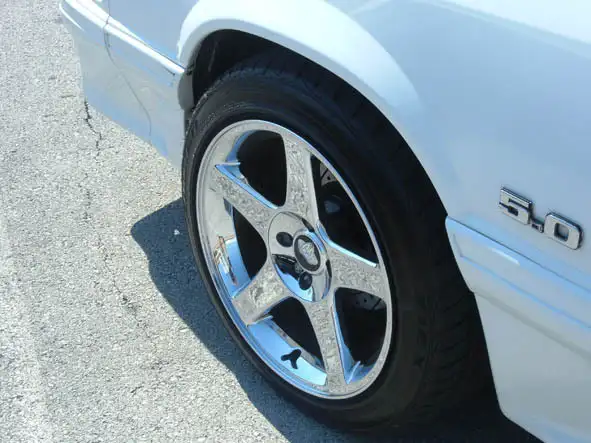

also can i see pics of gt hatches with 03 cobra wheels? i like them allot on lx's but havent seen any on gts..

Enjoy

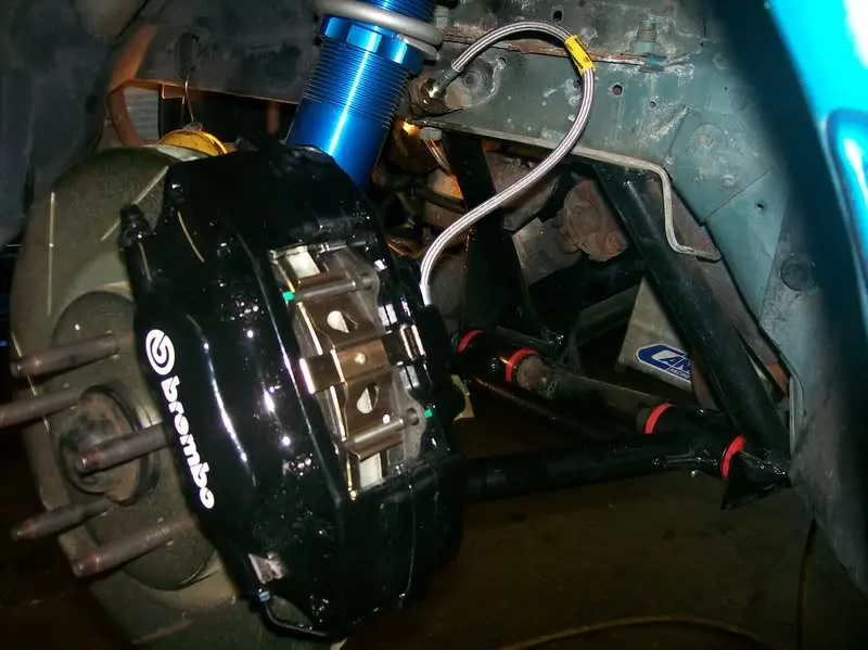

Here's mine 13" 4 pistions up front..
here's a pic of the brake setup... I was thinking about getting the 14" but then you need to get 18"rims.. then you start running into clearance issues and not enough meat on the rim..

Baer does sell decent 4-lug kits. Basically they are modified Corvette and Camaro brake setups. The 13" version was first used on the C4 vette (and later the Sn95 Cobra) and the 12" version came on special 4th Gen Camaros (1LE package) i beleive.
You can use the 12" with 16" wheels I beleive. All it is is a 12" version of the Cobra brake setup.
Downside is cost, but if you have a set of 4-lug wheels you like, then this will allow you to keep them
