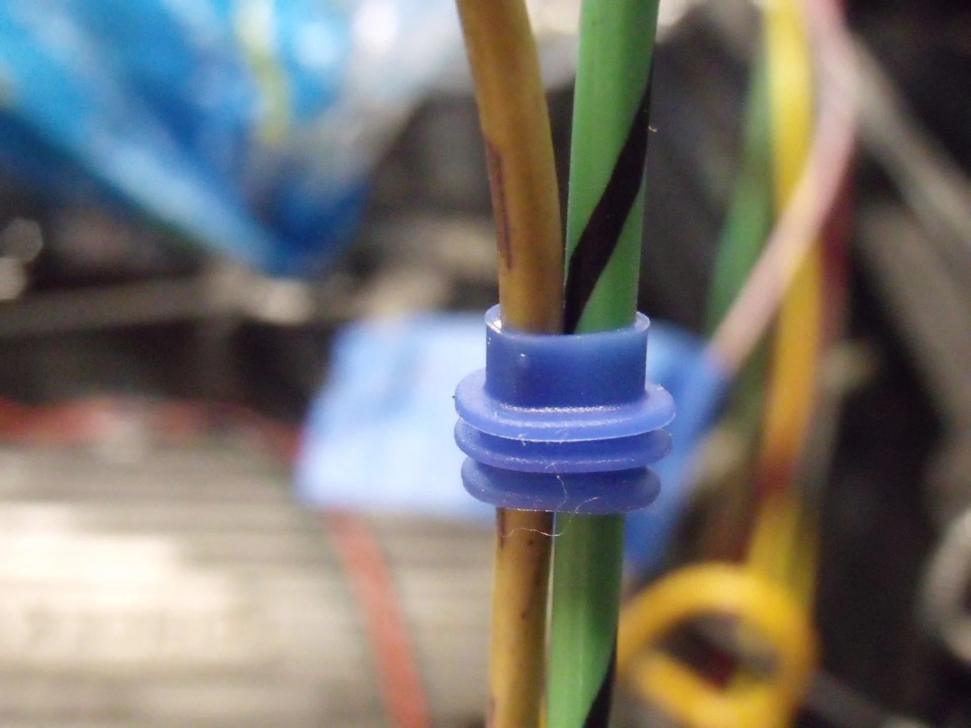

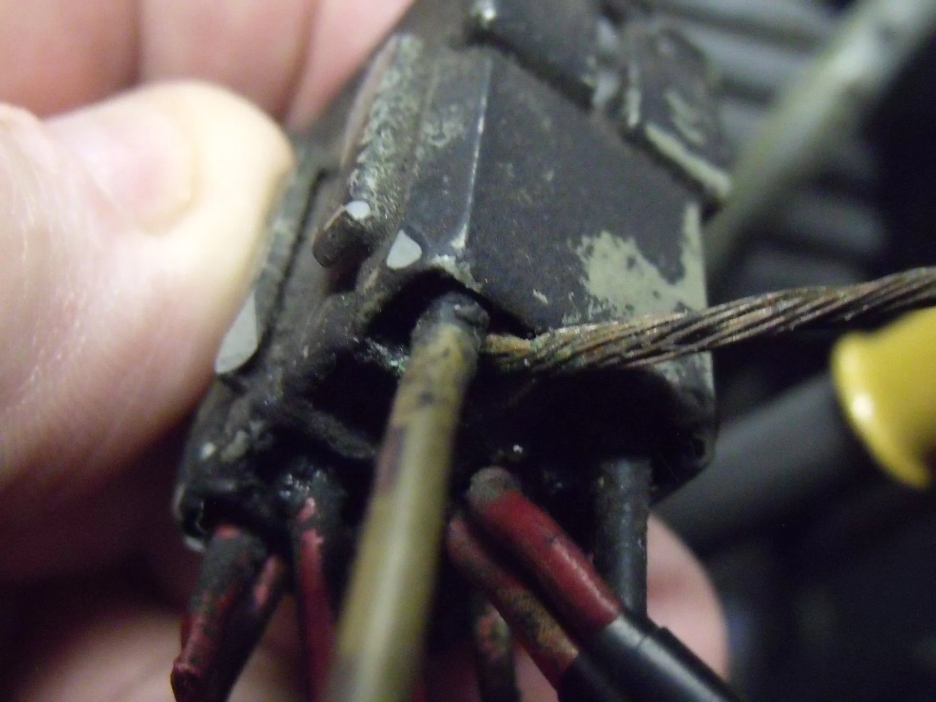

Here are some pics... The General is more intune with what I need help with... 16-18 gauge wire for my AC system on the car.... I had hoped there were some " professional" ways to do this in the last 30 years since I last looked......
The top picture is the stock connector.. The top left green/bare wire comes in one side and only one wire comes out the other side.. Power splits off there and goes to two different areas...
Bottom pic is the new Weatherpack connectors I am using. The blue rubber grommet needs to be round to work....

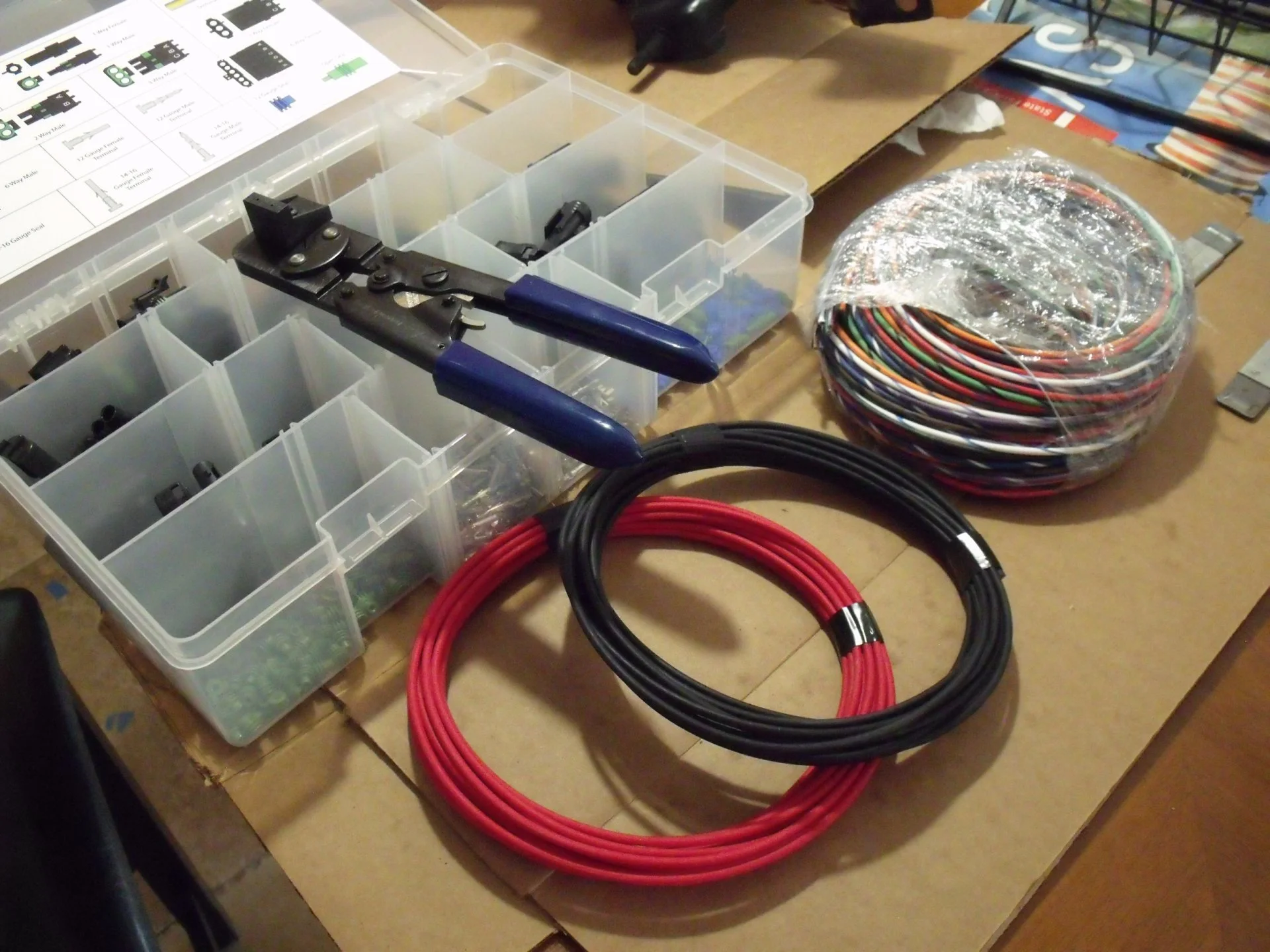

I have wires, connectors and a $100 crimping tool. Thats not the problem..

I've depinned the connector before. You can still get a lot of these various crimps online, even amazon. Would need to see what style connector pin that is. In the past, i've recrimped two wired to one terminal and then just added it back to the plug.
