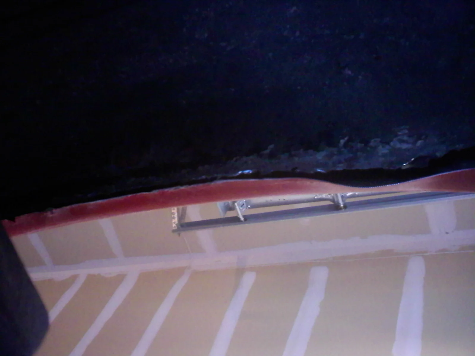

the wheels are 17 x 9's all the way around. all i have is one pic from underneath the passenger rear wheel area. its not great, taken from my phone,but for now it will have to do, tell i can snap some more tommorrow afternoon
Sorry the attachment is huge.:notnice:
It didn't really roll so i think i'll have to cut the inner panel with a wizard wheel (praying for steady handings) which will allow me to start bending the lip up.
to really get the fenders to roll good takes a big hammer you def got that one pretty much done. If you are running 17x9 wheels and SN95 length axles that combo itself will cause you problems unless you have some huge backspacing on your wheels. I was running 17x8 wheels on my car with SN axles and the fit was fine, but when I test fit some 17x9 wheels it was obvious they would not work.
Also post some pics from the side so we can see how far out your wheels are sitting on each side.
