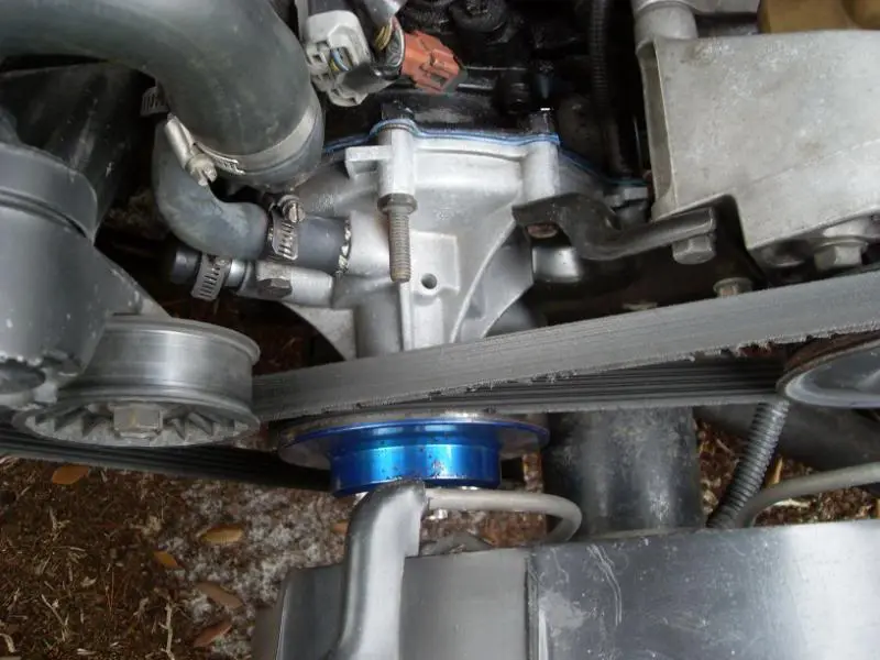

A year later, I now have a procharger setup and need to use the standard mustang length water pump. This one I have sticks out about a 1/4" to far to line up with the crank pulley. Is there a water pump pulley that is recessed or is there a timing cover for the fox body that has the provision for a mech. fuel pump?
Here is a pic of my current setup if it helps any:
