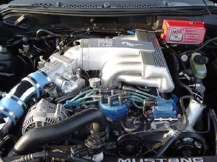

I don't have a problem with popping my hood.... :D
attachment.php
Did the wire hiding thing a while ago, real easy. All the connectors only go to one place so you can't screw it up. I still marked them just to be safe. Just get a crap load of zipties, take out the splash shields and go to town.

The oil cap, I just took a screwdriver and pryed off the top part of the stock oil cap, so now I just have the bottom part for the oil cap, I'm still trying to figure out something else since it looks kinda ugly.
The GT-40 flows decent, I'm only about 5-10 rwhp off from the Eddy/trick flow people. I'm at 297 rwhp and 322 rwtq on the 10th dyno run within an hour (heatsoak was very evident) with a slipping clutch. I was also running very conservative timing (max of about 28-29* in the PMS unit). The dyno tuner said with more timing and fuel and a new clutch, I should see 310 rwhp.
I could switch to the eddy and maybe pick up like 7 rwhp but I've always loved the look of the GT-40 and I'm more than pleased with it so far. If you don't care about looks, the eddy, holly or trick flow intakes will get you a bit more power, but I wanted a little of both so I went GT-40.
matthiasj said:
hey fast94GT, how do you like that GT-40 intake? I've never really heard or seen anyone with it. Does it flow better than an Eddy, or other name brand intake??
check the 94/95 faq sticky out. it flows the same as the cobra and explorer intake
